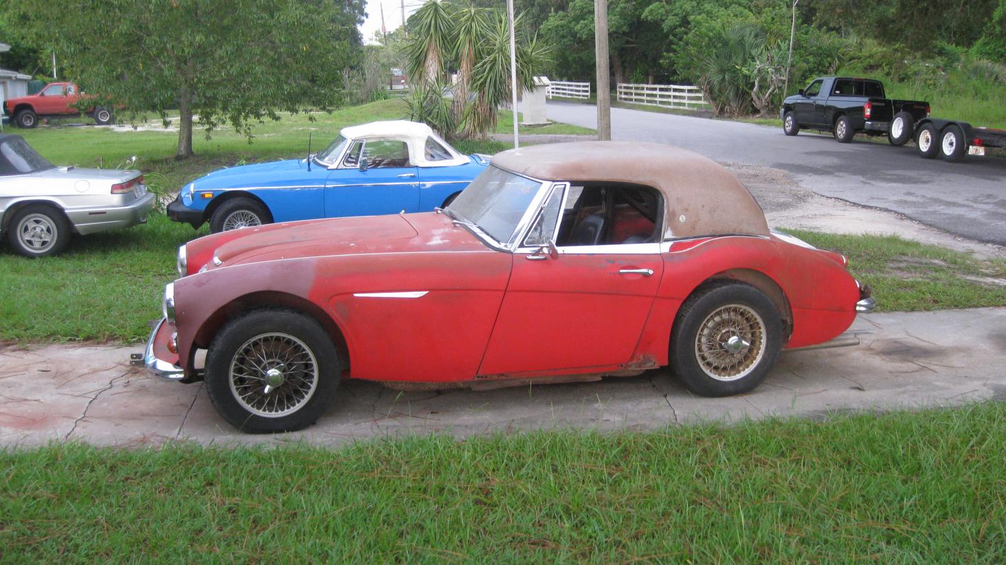

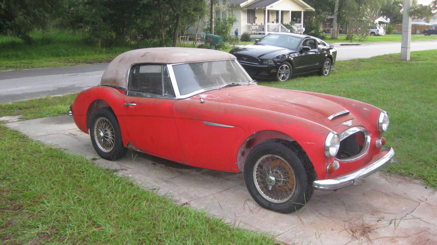

Found this car in a garage under a plane. Been sitting since 86. Got it home and have been working steadily to get her on the road. Still haven't turned the key or put a battery in. Fuel tank and radiator are getting serviced, brakes and clutch system are done, working on cooling system now. Engine and electrics are next. Cosmetics will come last when she's on the road. Rick

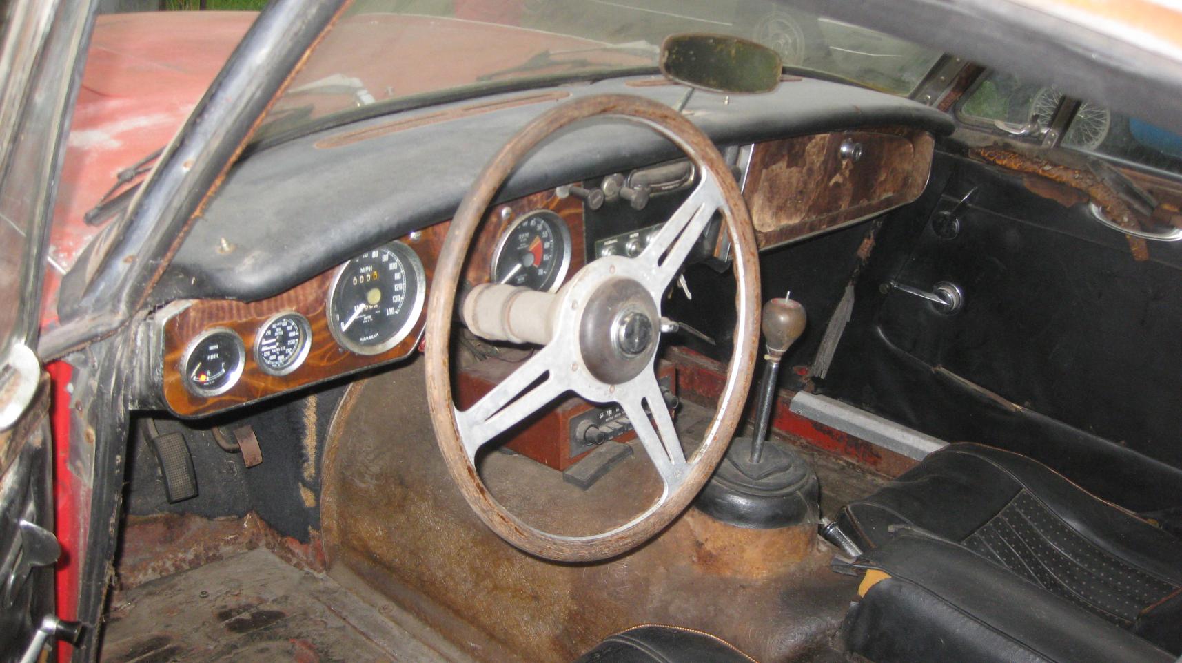

Bought it from the original owner (had original title). He was a pilot and she was an attendant. Found lots of foreign coins and bullets of different calibers in the glove box. Car came with another set of HD 8's and a manifold, new top and patch panels for the affected areas. Chrome is fabulous paint is shot. Outriggers and floorboards are great. Still positive ground. Seats are nice, need a carpet kit. Need to redo the wood. Original owner pickeled the engine well before putting away so I've got high hopes it will start without an engine rebuild. Ran when parked.

Plan on fixing the sills and doglegs with the included patch panels and paint it at home.
Probably a very good candidate for painting at home. Just my thoughts, but I'd probably remove all the fender and doors, hood and trunk, fix the rust, and repaint. A solid red isn't so sensitive to painting the parts off the car as a metallic is. You'll probably want to take the windshield off, too, to do a really nice job. The hardtop, as a non-factory, isn't a real improvement to the look of the car.
Do you have dogleg repair panels with the wrapped-wire 'lip' on the wheel well side? One of the first things a Healey-knowledgeable person (potential buyer) will do is run their fingers along the wheel well edges to see if there's been a repair. Best if you can do the repair and leave the original lip intact. Also, some of the aftermarket sills don't have the slight curve along the bottom that distinguishes Healeys (for all intents and purposes there isn't a perfectly straight line anywhere on the body). Kilmartin has both, and are the best (remaining) repair panel suppliers.
