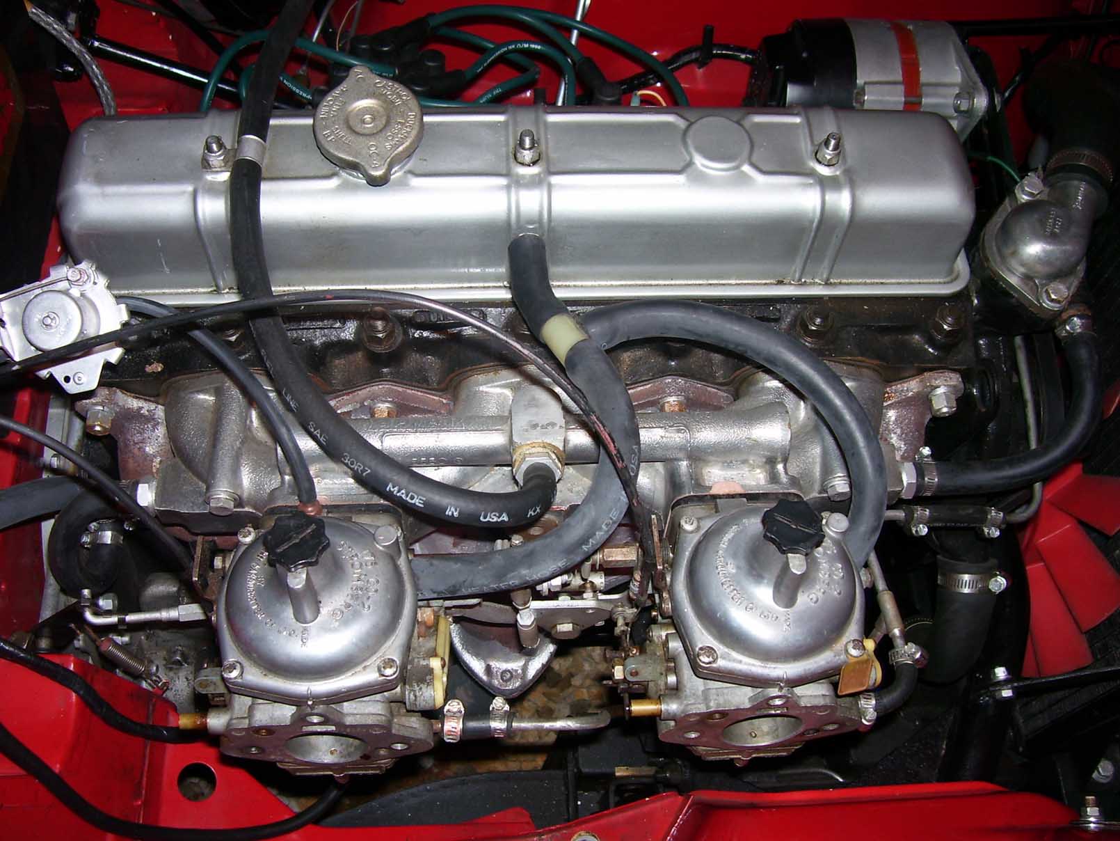

1) wrong valve cover - should be chrome but it is painted
2) wrong carbs - it has cd2's with adjestable needles

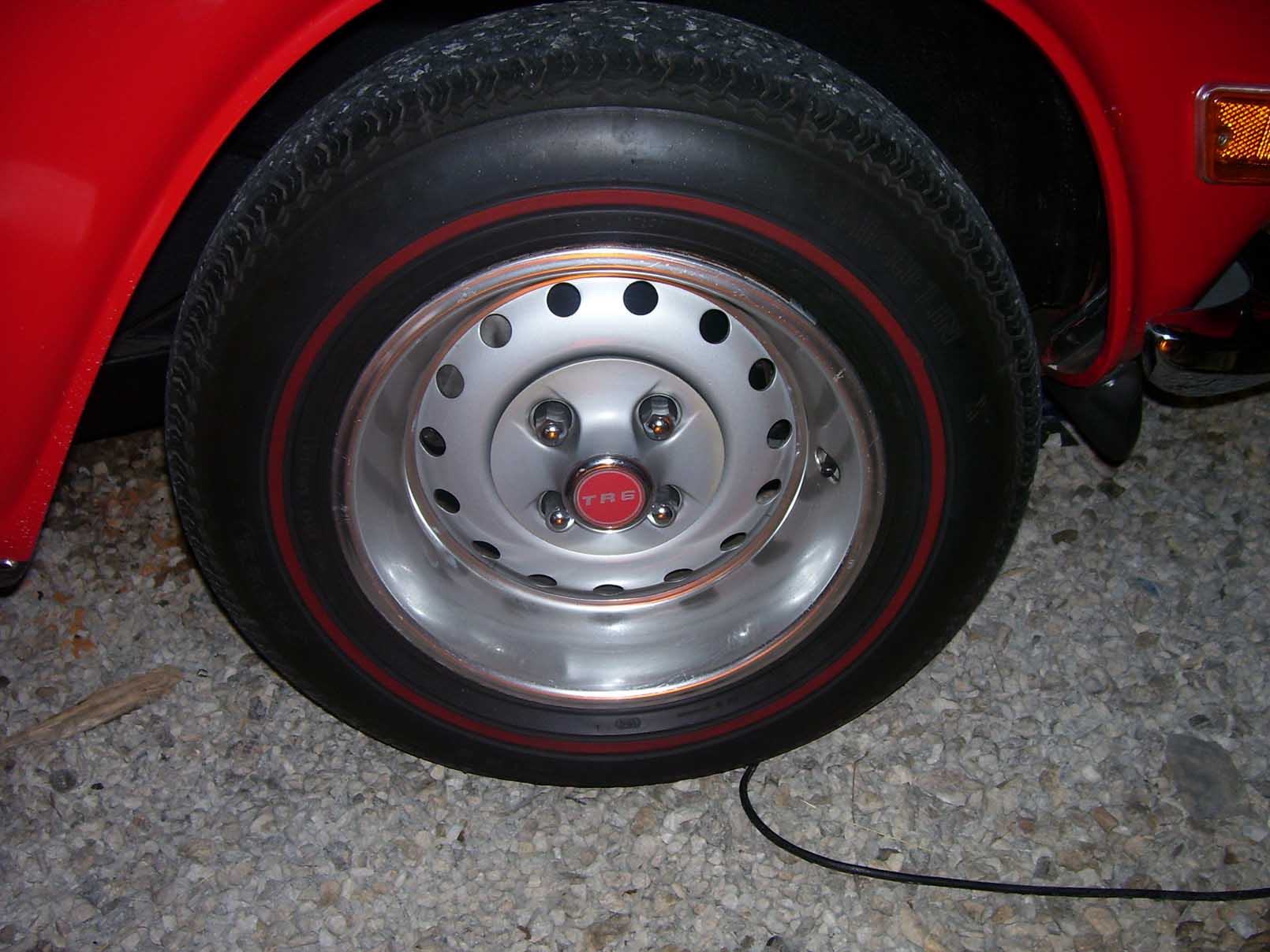

6) 15 hole metal rims with silver center caps

6: This is very common to see later wheels and center caps. A 1969, if it didn't have wire wheels, would've had the "pseudo-Rostyle" wheel covers as the TR250 did. Those wheels and wheel covers are now pretty scarce.

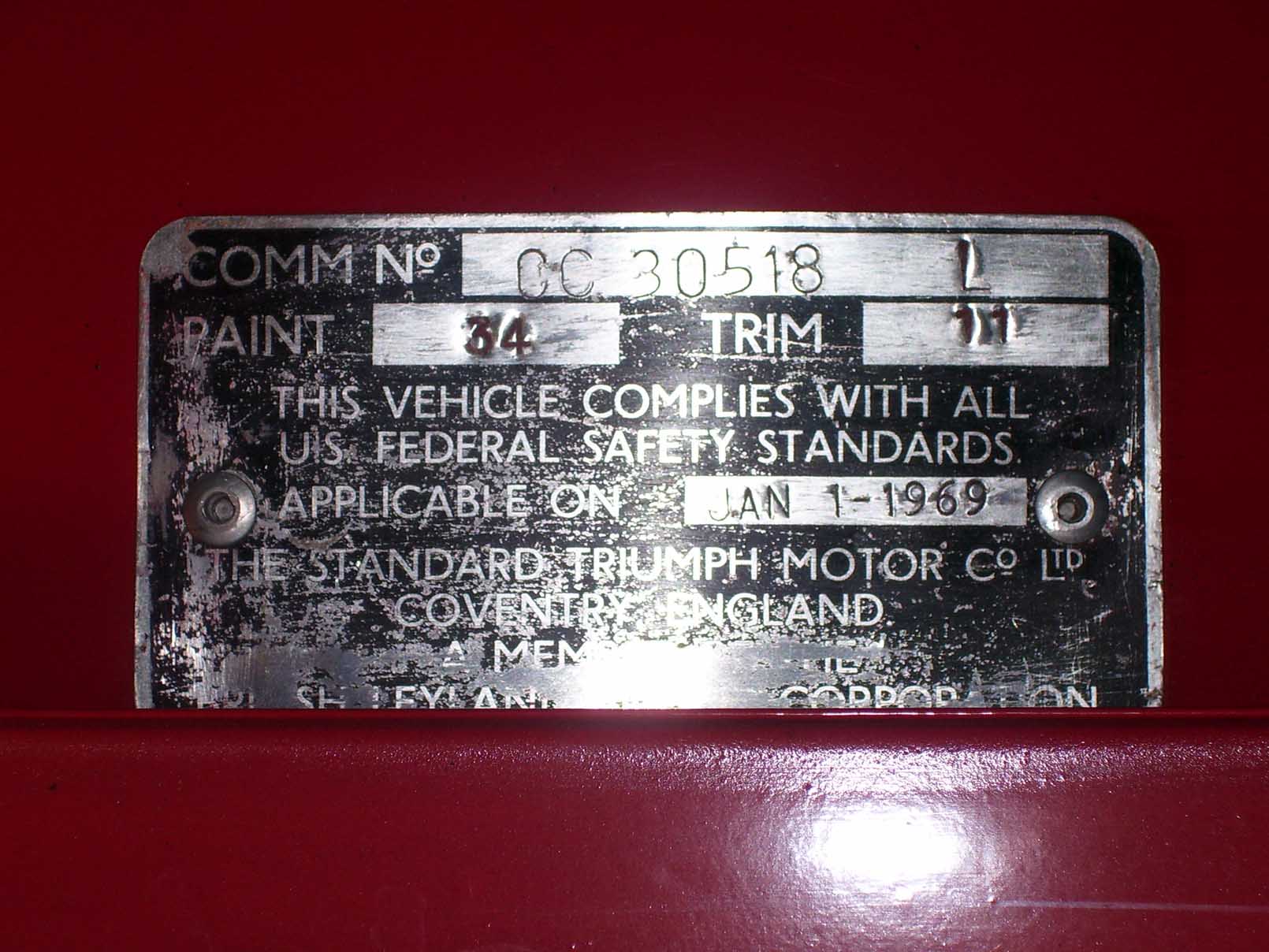

7: Check the commission number (and engine number) against the body number to see if they seem to go together.

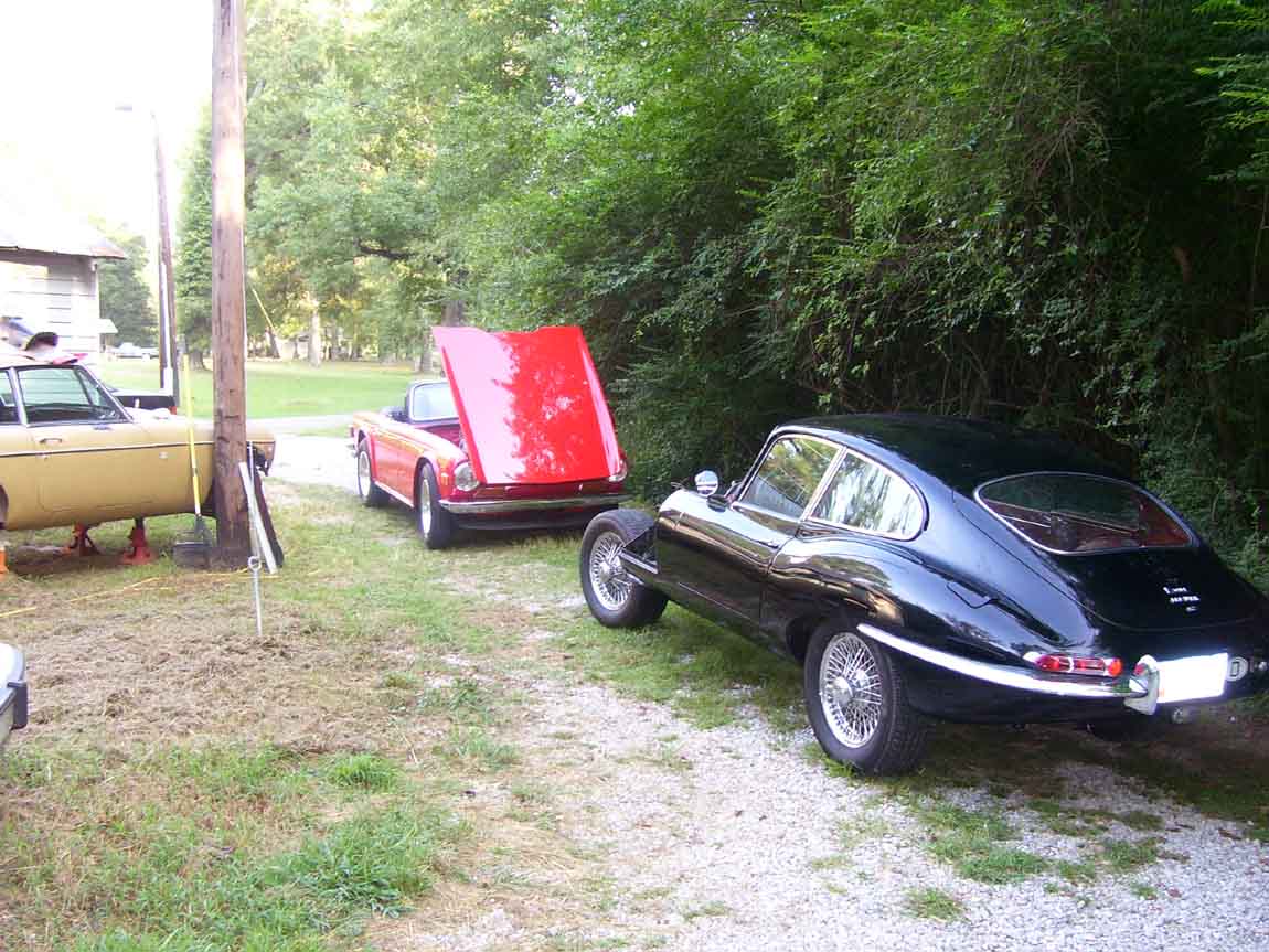

You can tell where the guy put this car on a lift and just painted the underside... There was no "frame off" restoration. I'm sure of that.
If not I'm mistaken this should be a TR250 with a different body, Thanks to Mr.Karmann. So the car should be set up like a TR250 right?
Should I keep my big mouth shut and say "Yes Sir, nice car" or should I raise question to him? When I said he paid too much I mean he paid WAY too much. on the order of $24,000. The car has a Clunk in the rear end. (broken motor mount) the Tranny is Knackered Up and I'll be rebuilding the engine next week.
The funny thing is he has bought another TR6 and it will be delivered to me in two weeks for inspection.
P.T Barnham had a saying about guys like this..."One is born every minute."

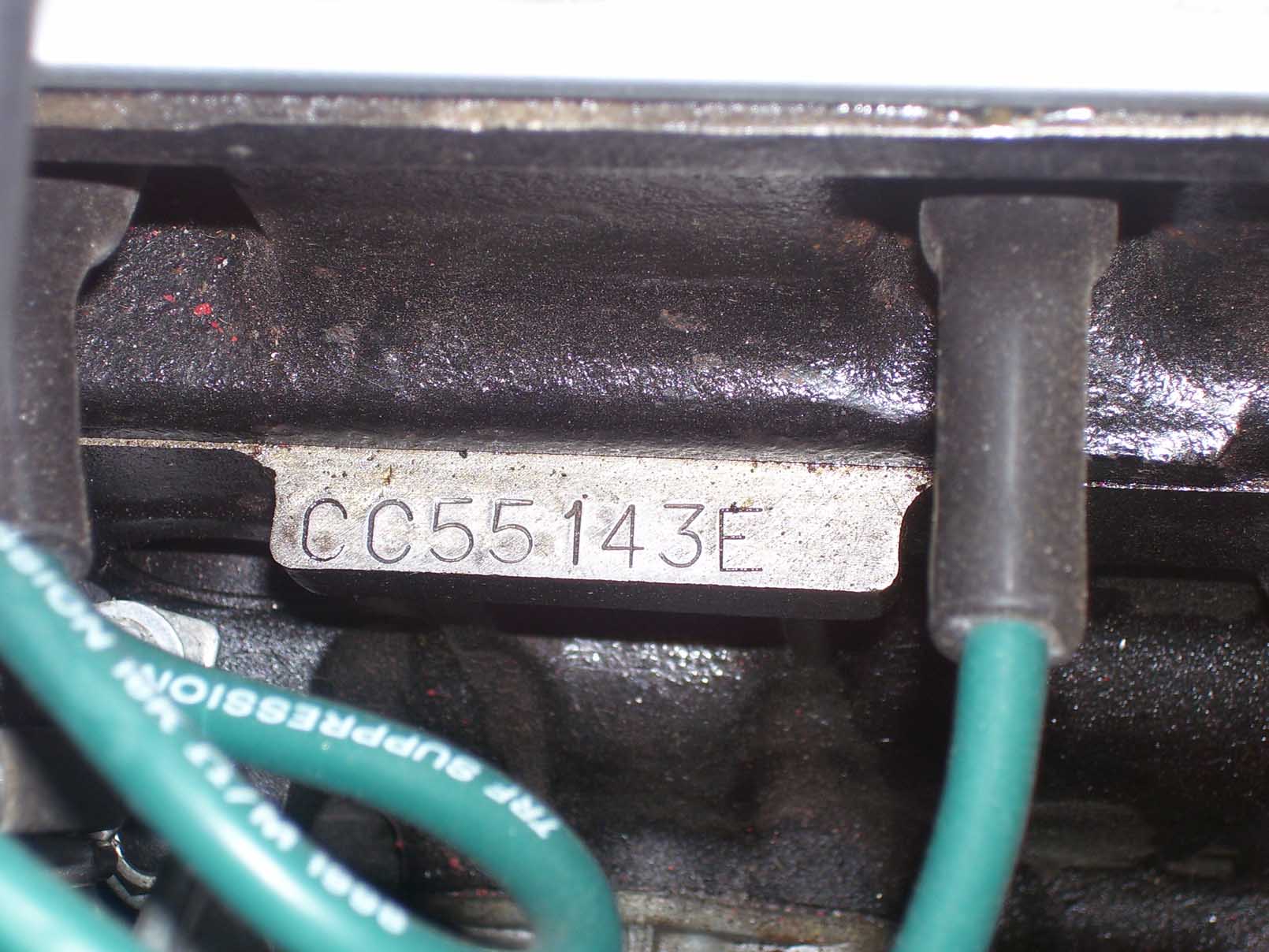

The engine serial number tab of a TR250 is easy to
locate on the block --directly across from the
brake servo. That number will tell you immediately
if you have a TR6 block or not.
My "69TR" has vastly different CC #s all over the place.

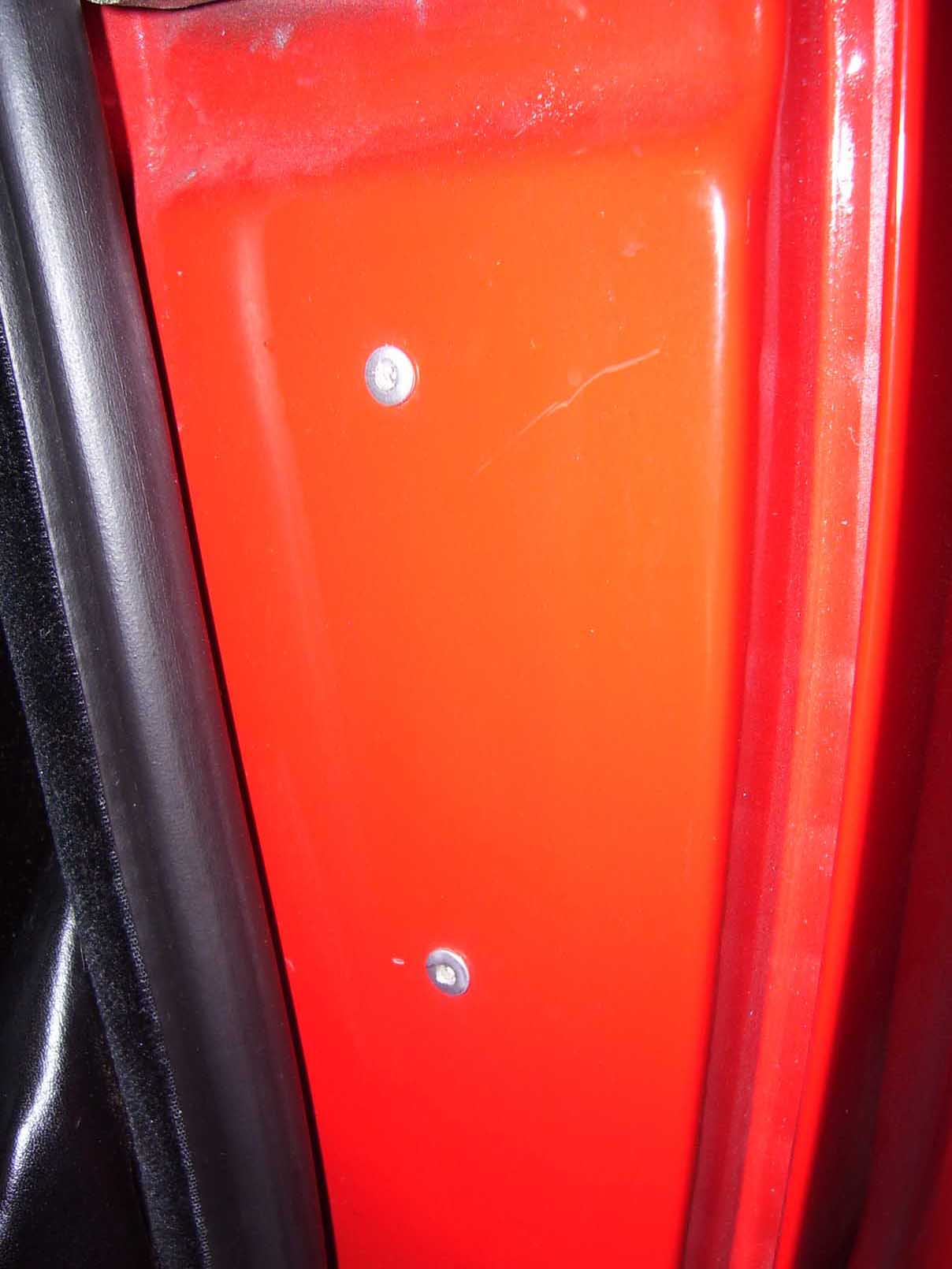

Here is the spot on the door frame that to me looks like there was a comission plate at one time.

valve cover not chrome, wrong carbs, and isn't there suppose to be a EGR valve on the intake manifold?
