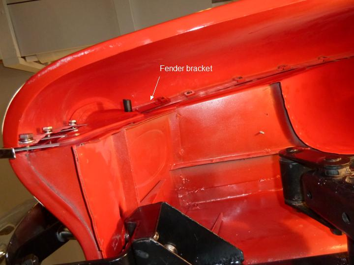

Where does the short piece with the cage nut go on the car. I see where the lower support goes but see no evidence of the other part. It is about 2 1/2" long with a 3/8" turn up on one end and a cage nut on the other end.
David
CJD
It's the rear-most hole. All I can deduce is that the long tab on that nut is to either help installation or to spread the clamping over more area.
M_Pied_Lourd
Hi David,
Borrowed this picture. You can see the little clamp piece in place
Cheers

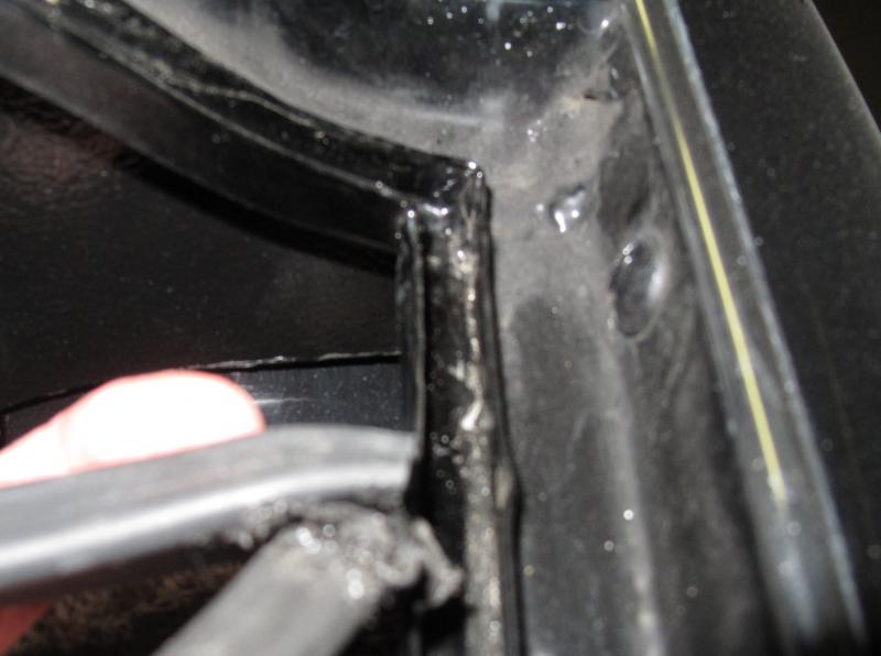

Don Elliott
The real name for the 5 screws that go inside the trunk lid on each side are called "TRUSS-HEAD" screws. They are domed like Tush says - but they have a very shallow domed head.
Don Elliott
Original Owner 1958 TR3A
