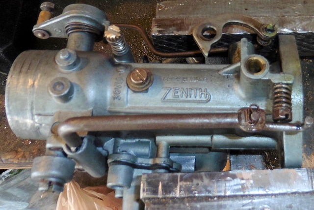

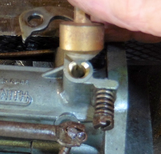

Hi Doug, my progress report was posted because you asked for updates! To your questions:
1)This car has a Zenith carb. I'll try to attach pix of how I chamferred the already existing brass bush to ready it for an o-ring. I just use a countersink bit. The bush was probably installed decades ago, as IT was worn. I've fixed several of my SUs by putting one (or two) o-rings on the throttle shaft with some nice durable axle grease to protect the o-ring from decay.
I've used Jeff and also like his work but the diz is fine, just have to figure out my latest FTL (failure to launch)

Nice fix on the carb. I assume that a flat linkage plate holds the o-ring down in the countersink and squishes it slightly against the shaft.
doc50
doc50
Yes, exactly. You'll always need something to push against the new O-ring.That's the same as with SUs too.
