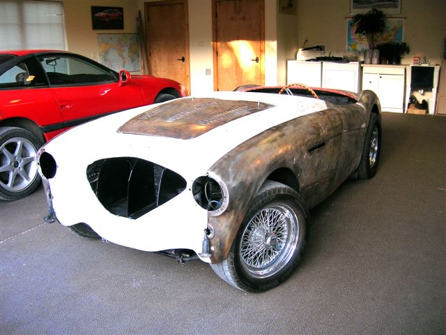

When I was reassembling my 100 I did not attach the vertical "fin" to the apron panel. Question...it seems that this piece really does not have much value in cooling the Healey. Or..am I missing something....Have not had any cooling issues since the car is back on the road. I am interested in any feedback.

I doubt if it has much effect on cooling. Read once that it was there to block the straight line of sight view. In other words, you can see straight through the front of the fender wells without it. Strictly cosmetic.

I mounted my oil cooler to the horizontal in front of the radiator. I left the verticle panel in (with a cut-out for the cooler) to provide some ridgidity to the assembly. Don't throw it out.

...I put 2 more verticals in there to keep the air going in the rad instead out the fender wells.

I put side baffles between the radiator & the inner fender panels to force the air through instead of around. It helped a little.
Interestingly, I found that the louvered hood greatly increased the radiator air flow & cooling. Conclusion is that the air can get into the radiator pretty well but has no good place to exit. I first found this while driving around in hot weather with the hood/bonnet removed. Maybe this is why the rally cars had the large side vents cut into the fenders.
