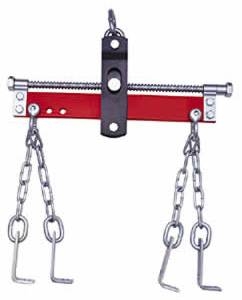

Tony- any cheap foreign tool store will have a lifting bar that is perfect for the job

Agree with both the above.
A standard "ebay" engine crane is enough to do the job. BUT the horizontal leg extensions will be required and to get these to fit under the car you will have to jack up the front wheels a few inches, if you take the front wheels off you won't be able to roll the car backwards to clear the shroud. I had to do this, with help, - it was a bit of a fiddle but worked.
Headroom in a typical garage is limited, I recall smashing a flourescent tube with the consequent glass shards a nuisance
to clear up. As noted above the angle leveller that often accompany the cranes are a godsend. The brackets on these are similar to those shown in the manual.

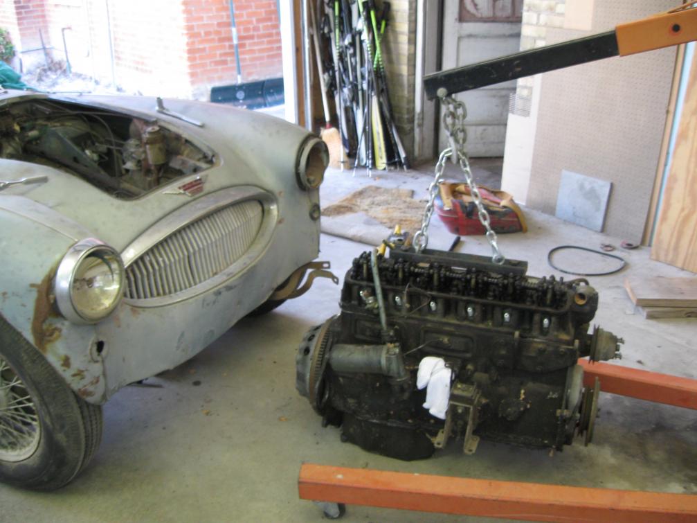

Bob,
I don't have measurements, but this will give you an idea of the height:
You can also see that I have the front wheels raised so the crane can fit under the car. This is necessary to get the end of the hoist far enough into the engine compartment. I prefer to remove and install the engine and transmission as a unit, it really saves a lot of time in trying to mate them back together on re-installation. Nevertheless, there's always some moments of anxiety when the lump is swinging over that delicate shroud.
Keith_M
You can indeed lift the engine by the head studs, but I would recommend using something to keep the load straight up. I used a piece of U-channel in which I drilled holes for two of the head bolts (the two longest ones that hold the valve cover on). I installed a couple of heavy duty eye-bolts on either end. It looked like this:
The only disadvantage to this is that I don't think you could tilt the engine enough if the tranny were attached. Also, I was able to find a hoist that fit under the car without jacking it up.

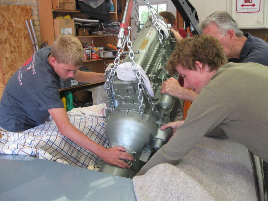

Here is a picture showing installation with the tranny attached. I think you need to attach the chains pretty far forward and back to achieve the correct angle.

I just removed my 100 engine and trans in one shot. Secret is to jack up the rear of the car with jack stands which changes the angle of the engine and tranny exiting the car. Attach your chain or lifting device. Use a floor jack to jack up the rear of the tranny to remove the trans mounts. Jack up the engine hoist arm, start sliding the engine hoist forward and the floor jack forward, lower the floor jack, continure to raise the engine hoist arm and slide it out. I used a piece of chain and was a couple of links off and had to push the back of the tranny down with my hand but it was balanced and did not take much effort. Make sure you remove the drivers side motor mount so it will not hit the steering column
