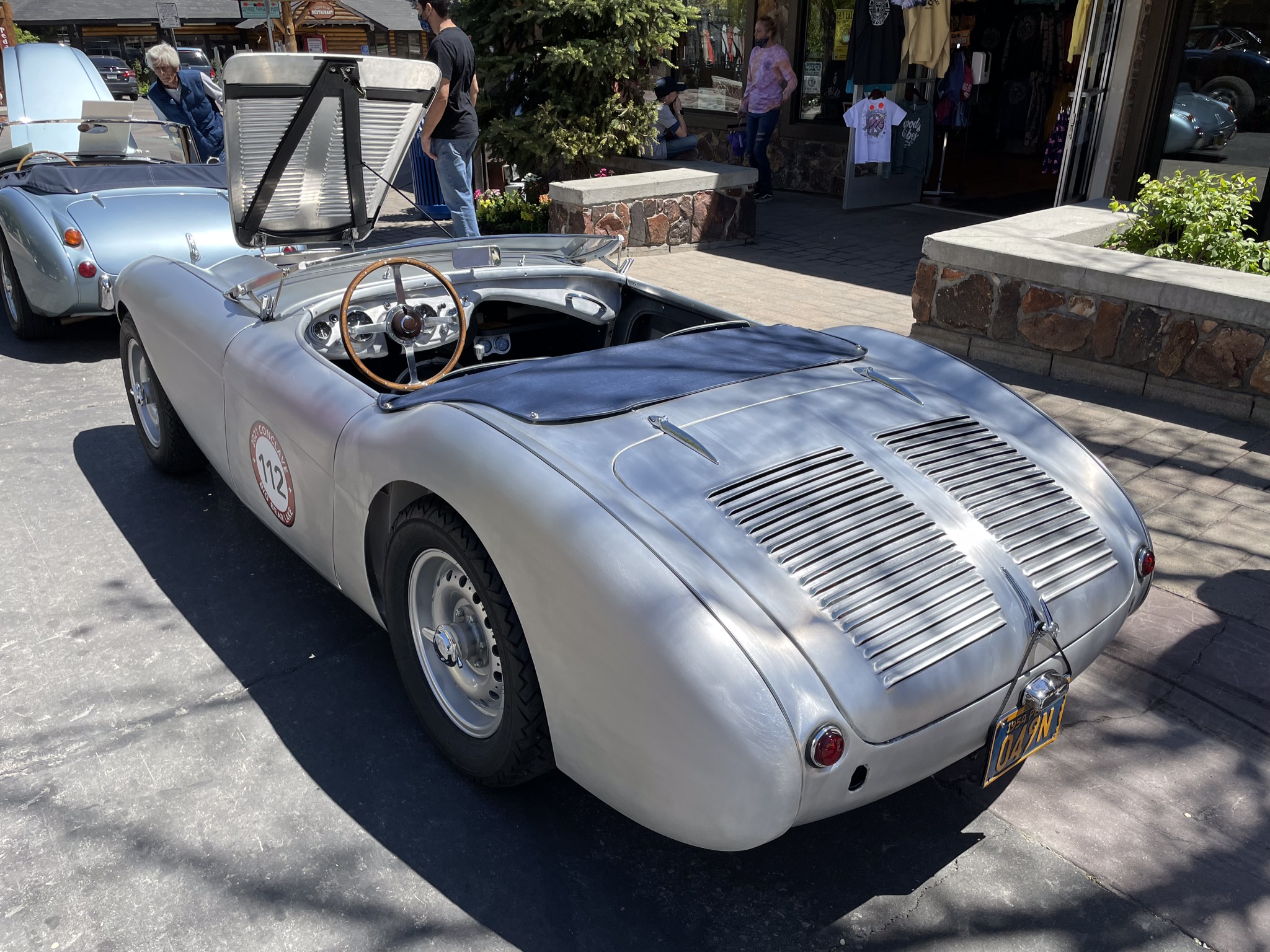

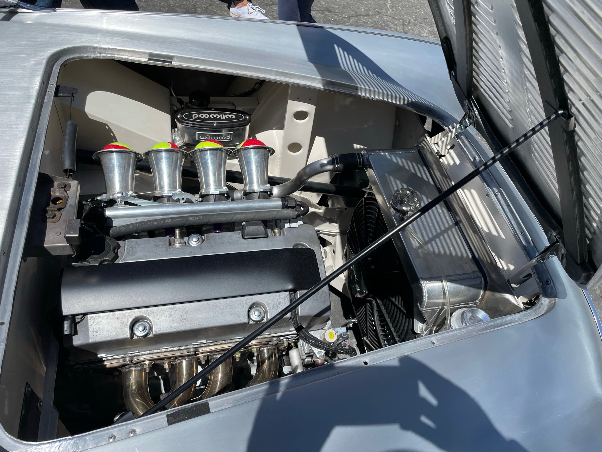

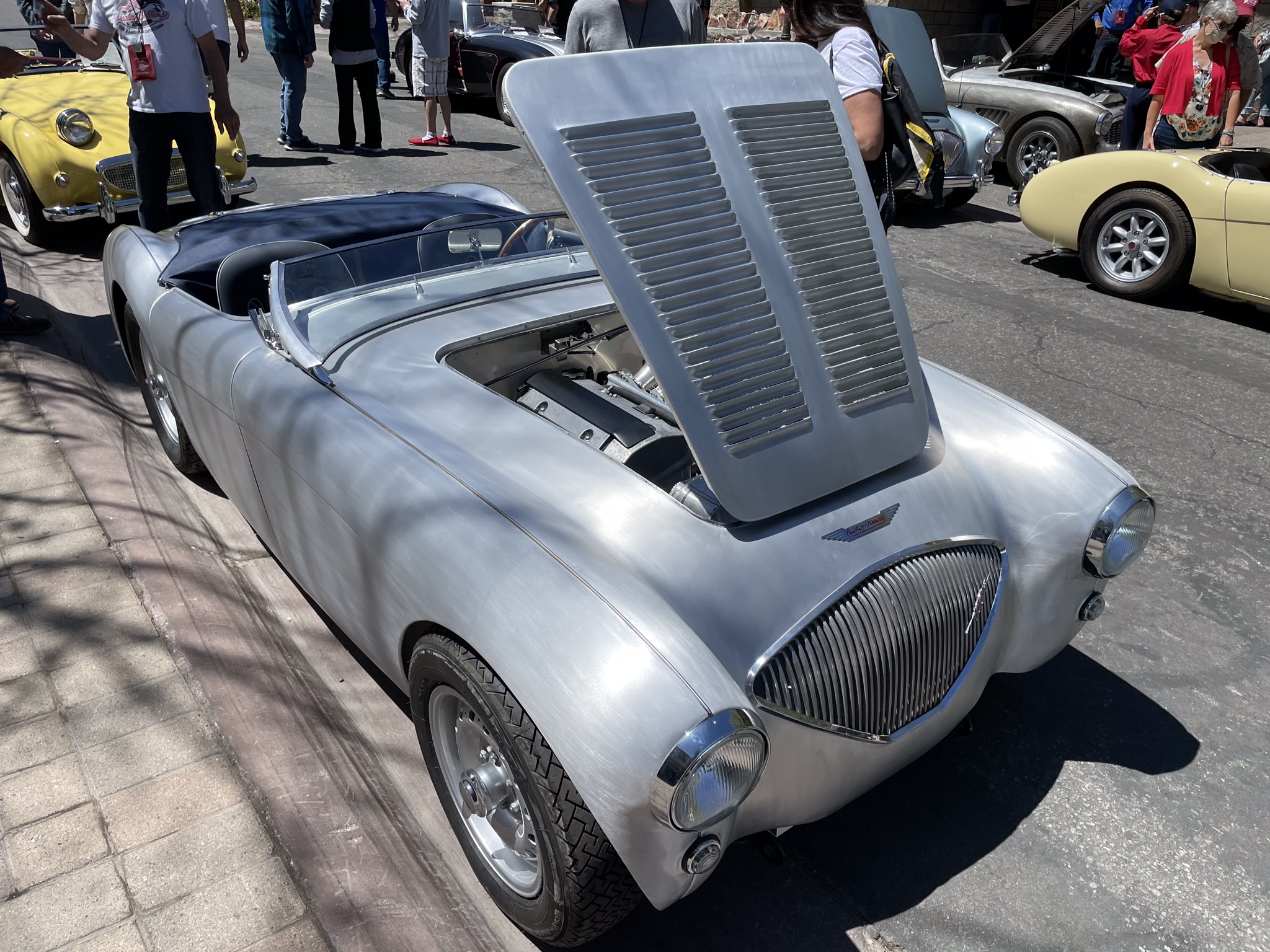

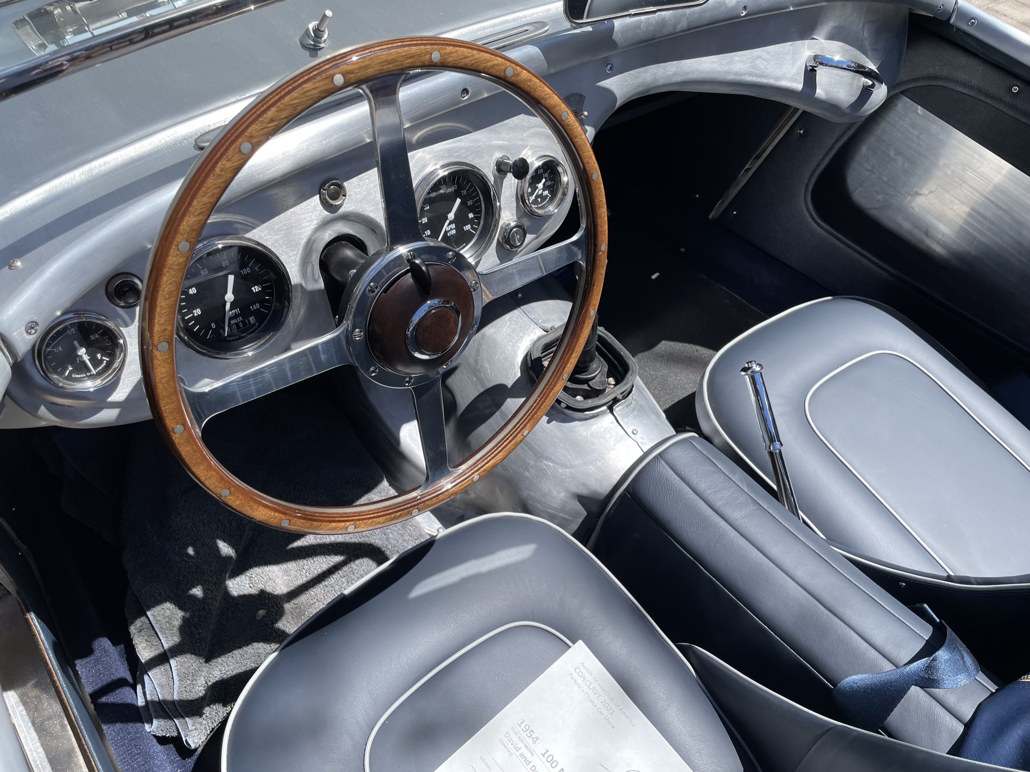

Here is a Honda S2000 engine and 6 spd trans in an aluminum bodied BN1 - the 2 litre version has 237 hp and revs to 9000 rpm!
Another suggestion might be an Alfa Twin Cam and 5 speed from a 105 series - very light at 280lbs for the engine...

I saw that beautiful all aluminum BN1 with the S2000 at Concave. But that S2000 motor is not my idea of "old school". As for the Alfa suggestion, I have a '76 Alfa Spider Veloce with the 105 twin cam engine and twin Dellorto carbs. It's a sweet motor in my little Alfa but not torquey enough for a Healey transplant.
