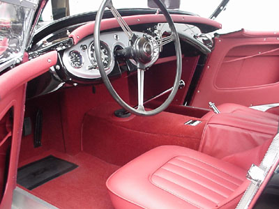

Do the gearbox tunnel and the tunnel extension (piece between the tunnel and the firewall) first. It's the most difficult, determines how the floor carpets fit and will make the rest of the fitting seem simple!
