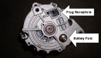

Saturn Alternator and Replacement Plug

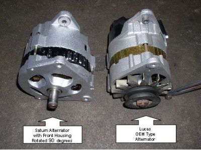

Note that the mounting holes on the Saturn unit are approximately 90 degrees opposed to those on the Lucas. You must remove the serpentine pulley, cooling fins and the 3 housing bolts. Rotate the front housing approximately 90 degrees clockwise. When rotating the front housing, take care to lift the front housing only enough to rotate it. This will insure that no internal damage occurs. After rotation, replace the 3 housing bolts and tighten. The replacement plug is also shown in this photo.
{As you can see in this photo, the mounting "ear" on the front of the unaltered Saturn alternator that you will use for this conversion is, as said above, 90 degrees counter clockwise from where you will want it to be when installing. Follow Daryll's instructions, and CAREFULLY lift the front cover JUST ENOUGH to be able to move it clockwise into the correct position. If you move it apart too far, you risk having to dismantle the unit to correct the situation!!!!! ~ Bob M.}
Saturn alternator with front housing rotated 90 degrees clockwise and Lucas OEM type alternator
Replace cooling fins and install v-belt pulley to Saturn Alternator

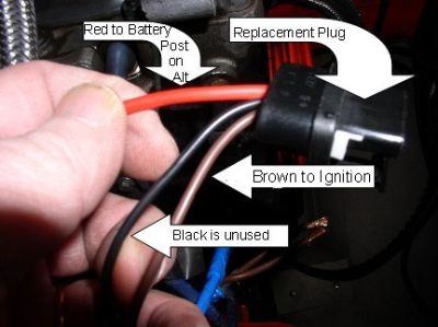

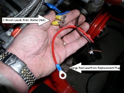

Remove Lucas plug from wiring harness and attach the replacement plug as shown below.
REPLACEMENT PLUG -Attach Brown wife to Ignition lead from harness (Brown wire with Yellow stripe). The large Red wire attaches to the battery post on rear of the Saturn alternator (See below). The Black wire is not used.
UPDATE: In the event a 3 wire replacement plug is not available, the 4 wire can be used. Attach the large Red wire to the BATT terminal at the rear of the alternator, attach the Green wire to the Ignition lead (Brown/Yellow). The other two wires are not used.
Attach Brown Starter Lead(s) (Hot) from wiring harness and Red wire from Replacement Plug to battery Post. Depending on the year model of your MG, there may be one or two leads from the starter.

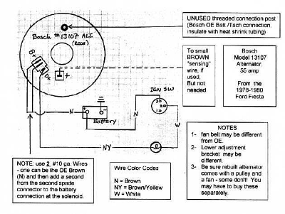

Wire Color Codes N - Brown - Battery connections (at solenoid) NY - Brown/Yellow - dash warning light W - White - Switched power from ignition switch
Many thanks to Daniel Wong for the use of his photo graphic, below ©.
NOTE - I recommend using two # 10 ga. wires to route alternator output to the battery - Use the existing large OE Brown wire and then add a second 10 ga. wire from the second spade connector to the battery connection at the solenoid. I used the very flexible rope-lay type power cable used frequently for providing 12VDC power to high current car stereo power amplifiers. You should be able to find this wire sold even at Wal-Mart, Circuit City, or Radio Shack. Use a 3/8" female connector (available at NAPA {Belden #784349} or other auto parts stores) for connecting to the alternator output male spade terminals. YOU MAY NOT WISH TO ADD THE SECOND #10 ga. WIRE, BUT IT WILL SIMPLY ALLOW A SECOND LARGE CAPACITY ROUTE FOR POWER FROM THE ALTERNATOR TO REACH THE BATTERY AND ALL THE OTHER LOADS IN YOUR ELECTRICAL SYSTEM AND WILL DO NO HARM. Adding the second wire may not do much for you most of the time, but when you do find

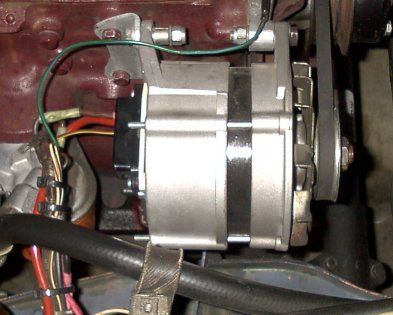

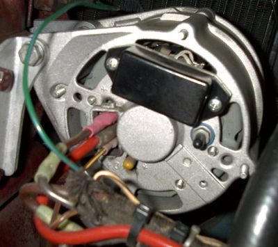

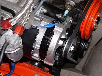

The only connections to the Bosch {Lucas 18ACR} unit that need to be made are those which you will find in the larger plug cavity!
You can carefully pull the existing connectors out of the connecting plug(s) of your early B by inserting a very small thin tool (I have used a fine jeweler's screw driver) into the plastic connector(s) and compressing the "ears" or barbs that hold them in place and pulling the connectors out.
The two large (3/8") male blade connectors (B+) in the plug well lead to the battery wire connection on your starter solenoid. Use the existing large MGB brown wire and a second # 10ga. wire which you should route along the same basic path. Use only automotive or marine high strand count power wire as discussed above. It will allow you to route it much more easily and do a better job of carrying more current. You will need to buy a larger 3/8" female spade lug connector to connect the new wire to the alternator output (B+) spade lug. The small (1/4") male blade connector (D+) in the well goes to the small brown/yellow wire for the indicator light on the dash. The small female connector in the MGB plug with two brown/yellow wires is from the dash. Strip the tape on the harness back to see which is the main small brown/yellow wire and which is just the loop. Use the main wire. If you cannot figure out which is which, do a continuity check with a Volt-ohmmeter between each brown/yellow wire at the alternator and the brown/yellow wire that attaches to the dash charge lamp. The correct lead will show continuity.
The threaded post terminal sticking out of the back of the Bosch unit is a take-off for a tachometer for some original equipment Bosch applications and IS NOT used here. Leave this terminal alone and insulate it with heat shrink tubing, electrical tape, or a cap plug cover. This does not effect alternator operation in any way.
The other terminal (+) found in a small well on the body of the alternator is the connection for battery sensing. On the new regulators provided by Bosch and other aftermarketers, this terminal is made part of the main (large blade terminals) on the Bosch unit and makes the unit "self-sensing" . You can then insulate the factory Original Equipment small Brown sensing wire's bare female connector with heat shrink tubing and push this onto the Bosch "+" or "Bat" terminal with no issues...... or..... you can tie this same wire back onto the harness and tape it off after removing the other end of it from the starter, just in case you ever want to revert back to the original system.

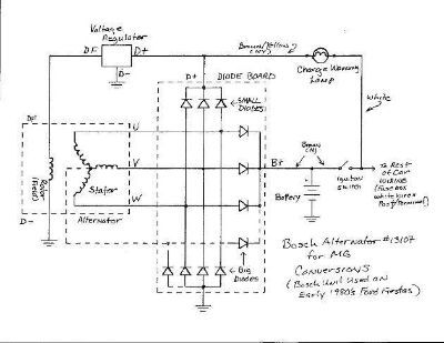

{For those who may need it, a schematic diagram of this Bosch Alternator's internal circuits is given below.}
