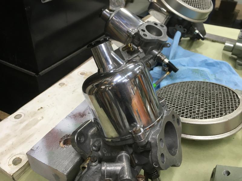

    IMG_0263.jpgstarting pulling out the carbs and parts today. the PO had them rebuilt.
    2 questions)
    1) i always thought the SU carbs with the brace on the neck did not use vented caps. the ones on these carbs have a hole in them. am i correct there?
    2) what do you all use for vent pipes on the carbs and how do you run them?
    Thanks

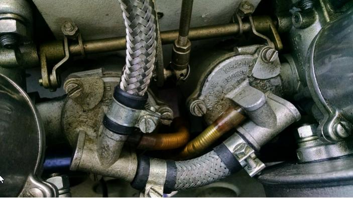

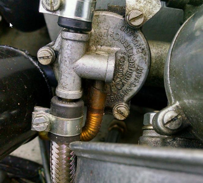

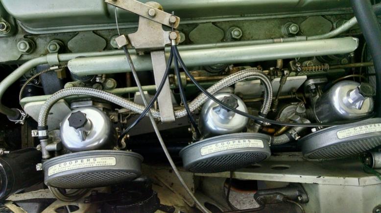

    Back to fuel/vent hose arrangements.
    Pix from Stretchit2's ex-Bill-Bolton BN7 mkII. Clear vent tubes bent 90 degrees with springs inside, length only about 3"
    TricarbF.jpg Front
    TricarbR.jpg Rear
    TricarbAll.jpg All

    I found one of those elbows today in one of the boxes. Going to loo for a couple more now.
    guess they did not worry about extending down below the manifold....

    The flexible vent tubes on my 62 / BT7 mkII don't extend any further than the BN7's. When the needles went bad I switched to Grose Jets [ball bearing] and they never vented gouts of raw fuel again.
