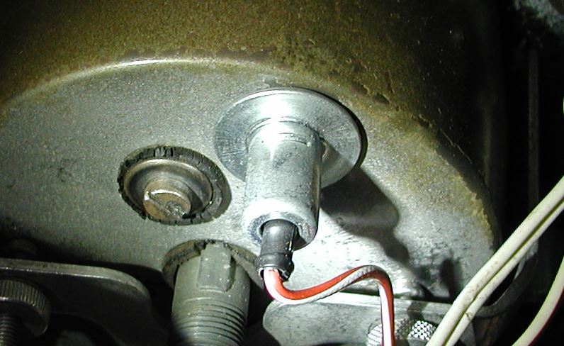

    Thanks for the idea. i did actually think of using the panel light switch.
    And speaking of panel lights... keep in mind i did not take my car apart... how are you supposed to wire in the panel lights for the small gauges? do you solder wire to them or should there be a clip of some sort?

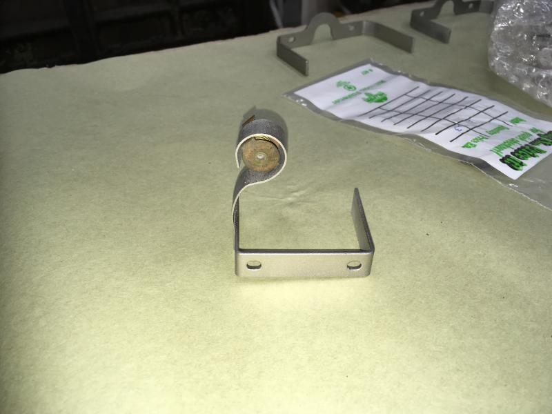

    The small gauges have that loop in the holding bracket that you show in your photo. The lamps should be in a socket that is a tight fit in that loop.
    I made a small panel to go under the heater controls for extra gauges and switches such as for fog lights.

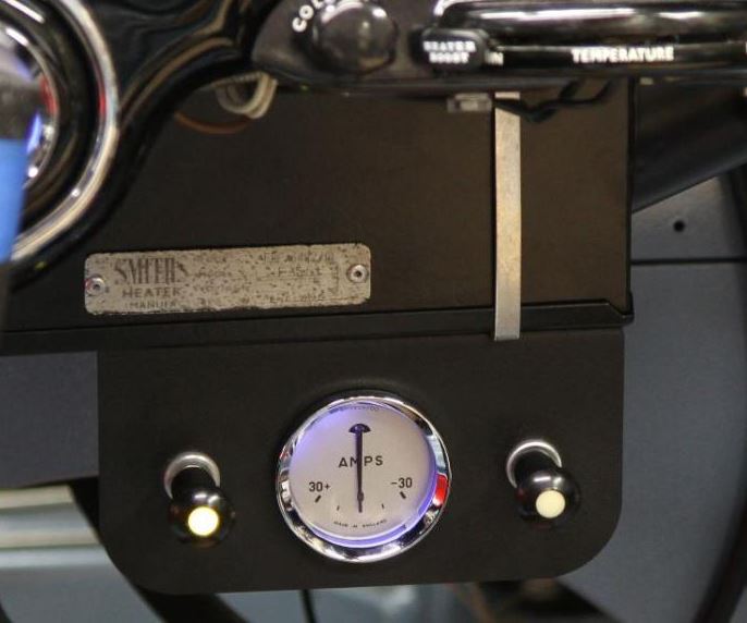

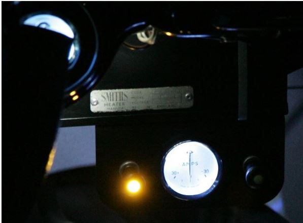

    I mounted my reverse light switch, and fog light switch for the factory optional L494 reverse light, and SFT 576 fog lamps utilizing original Lucas 56SA illuminated switches on an additional panel under the heater. The Lucas 56SA switches were packaged with both of the optional lights originally.
    I also replaced the incandescent bulbs in the switches with LEDS.

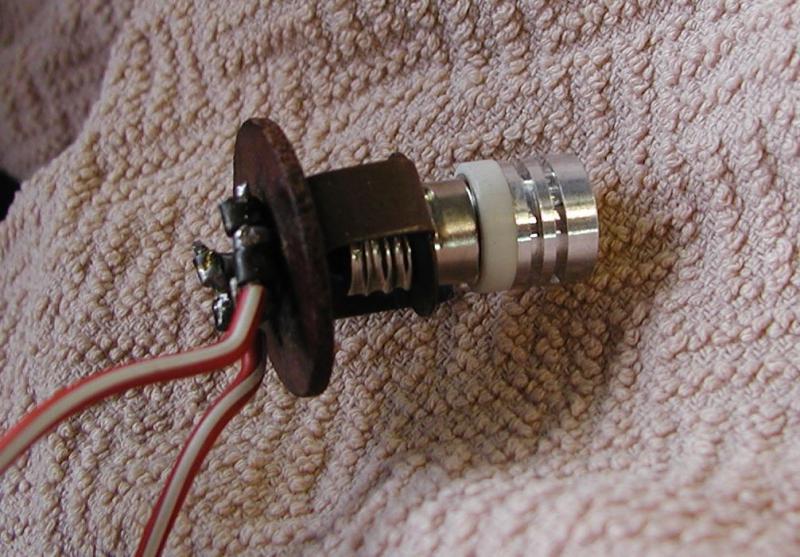

    The panel lights are all wired in parallel. The power for the panel lights comes off of the S1 terminal on the headlamp switch and goes to the panel light switch that is installed on the bottom of the dash under the tach. The output of the panel light switch feeds all of the lights. The grounds for the panel lights are just the body ground on the brackets for the fuel and safety gauge and the case of the speedo and tach. The wiring harness has grounds to install on the mounting studs on the instruments to provide these grounds. Your shop manual has the schematic showing the basic connections.
    Let me know if you want more pictures!

    ok on my harness, i have two bulb holders that are on long red/white wires. i assume they go in to the tach and speedo. the wires are long so that they can be run first to the bulbs for the safety and fuel gauge (pic of bracket above) and then back to the tach or speedo. i just don't know how the red/white wire is supposed to attach to the bracket/bulb shown above. i don't have any pigtails on mine.... but it is possible they got thrown in the box with the old wiring. So i will look there first.
    Thanks for the info.

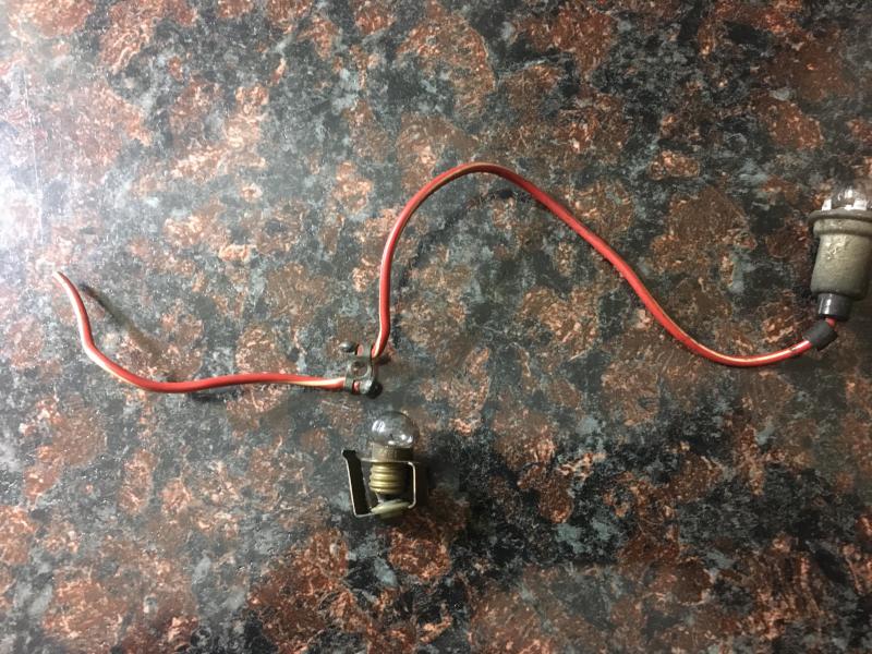

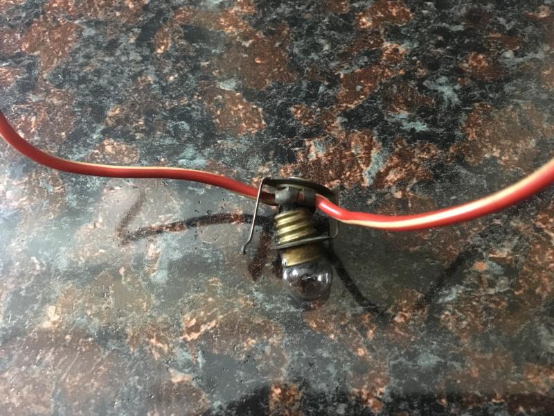

  15. #15
    Jedi Trainee Drone Dog's Avatar
    Join Date
    Jun 2017
    Location
    Seaford, DE
    Posts
    324
    Thanks Thanks Given
    1
    Thanks Thanks Received
    4
    Thanked in
    3 Posts
    Re: BT7 fog light switch
    ok, i went out and cut out the connections that came with this car from the old harness. easy to miss when i looked at the old harness...
    pic below
    so i was looking at this and it looks like maybe this connector (in the middle of the wire above) maybe fit between the bulb and the base of the holder. it looks like the base may have an insulator at the bottom which would have kept it from grounding..... well as long as you got it centered properly.... or am i wrong about this set up?
    see below

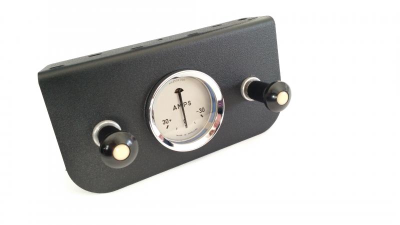

    Pretty easy actually, I could not fine the bracket I wanted, so I had one custom made. The company that made it for me liked my design so they added to their product line. They are available at the link below, just send him an email, he's very helpful! The Lucas 56SA switches are available on Ebay!
    http://www.cubbypods.com/gallery
    Quote Originally Posted by Drone Dog View Post
    pic below
    see below
    You are correct. The red hot wire comes from the headlight switch to the panel light switch. The red/white long wires go from the panel switch the to the fuel light and to the safety gauge, the hot wires then go from those gauges to the tach and speedo as single hot wires. The hot wires are in parallel on the fuel and safety gauges.
    I hope this helps!
