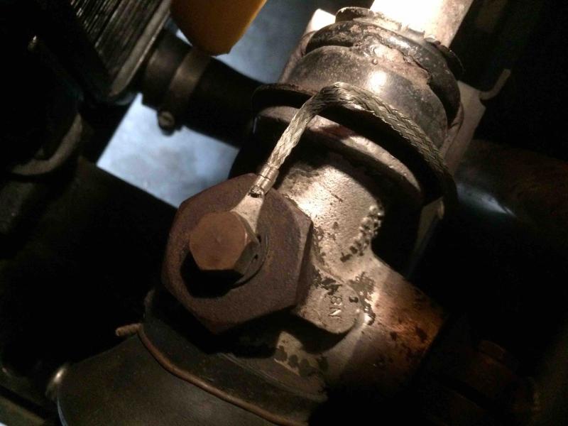

Merlin63Tr4
Mine has one lug attached to the rack grease plug, goes over the back side of the left rack mount and it’s other lug is attached to the rack mount nut underneath.
M.

shoopal
Oh, I see. I was assuming it was the same as the steering coupling ground strap but now I see that it is different.
Thanks to all
fpstude
Mine is grounded like the photo Merlin provided two posts above. It's been that way since I purchased the car 50 years ago.
KVH
Some of the new racks don't have a grease nut, and that makes is hard. I had to improvise.
