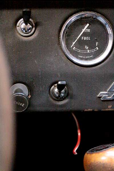

I figured I'd chime in here sooner rather than later in case anyone was aware of likely suspects. One likely suspect I have is what I was told was the headlight switch on the dash--The wire running from it (RW) is cut. Looking under the dash, I can't see a corresponding cut wire, and this shouldn't effect the brake lights and blinkers (though I'm aware of the Prince of Darkness, so I guess anythings possible).
The top switch is headlights. 1 click down is parking lamps, 2 clicks is headlights.
The red/white wire is the dash lights, they are turned on by the bottom switch but will only work when the top switch is clicked on.

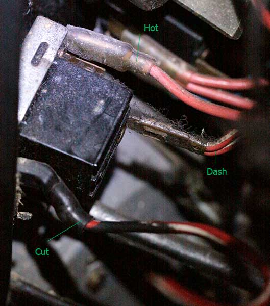

Looking more closely at the switch on the dash...There is a single R wire coming into the top (hot), a pair of RW wires coming off a single spade on the top, and the cut RW wire is coming off a spade on the bottom.
Looking at the diagram, I'm not sure how the switch on the dash could control any other lights but the dash lights...They RW wires only go to the four gauges, and the R wire just provides power...

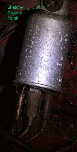

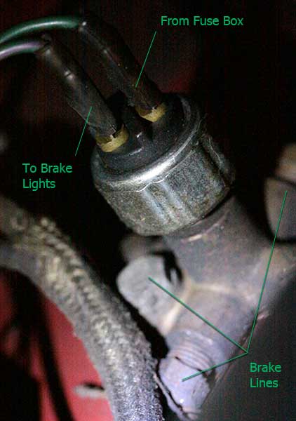

I looked at the hydraulically activated (!) brake light switch as well as the flasher unit near the fuse box...I don't have my voltmeter with me, so I can't confirm whether or not they were getting power in the right places...I just eyeballed them...
The brakes are good, but not great. Could that contribute to the lights not coming on? I guess the first thing I'll need to do is bypass that switch and see if the tail lights light up...Actually, the first thing I should do is eyeball the bulbs.

This is the back of the dash light switch (top of photo is top of switch).
Here's the brake light switch by the front right wheel well.
Some flasher for something near the fuse box...

That switch is the dash light switch. (red red/white wires)
The TOP switch is the head light switch. Find the brown/blue wire, it powers the lights
Embarrassing update: As surmised, I was flipping the wrong switch. Every light works.
I bypassed the brake light switch and the brake lights lit up, but I don't think there's juice getting to the switch in the first place. I'm gonna trace that green wire, clean the relevant grounds, and see what happens.

The ignition must be on for the brake lights to fire--With the ignition on, I get juice to the brake light switch, but no juice coming out when I press the pedal. The brakes work, so, I'm assuming it's that hydraulic switch.
Will I have to bleed the brake system to install a new switch? Even if I replace it, that thing seems likely to fail again in the future. Am I correct? Is there a way to hook up a simpler mechanical switch to the pedal?
no you won't have to bleed, and, there isn't a simpler arrangement. do you have a continuity tester? and a Voltage tester? if not, it is time to get them.
The brake switch is in the front of the housing for the brake and clutch pedal. you should be able to test the switch in place though the housing has to come off for you to replace it.
1. make sure the switch works with your continuity tester.
2. make sure you are getting 12 volts to the switch - I believe it is a green wire.
if the answer to both is yes, you need to start your way down the line.
the hydraulic brake light switch is easy to replace, and cheap. just get one that fits (3/8" IIRC) from NAPA. do it fast and you won't have to bleed the system, as fluid leaks out, but not air in. Check you master before and after, as it should be mere drops.
