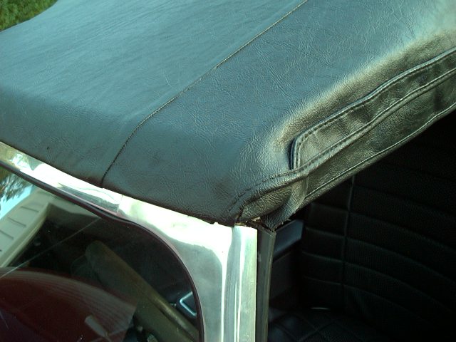

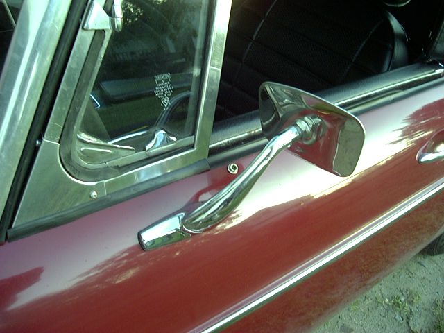

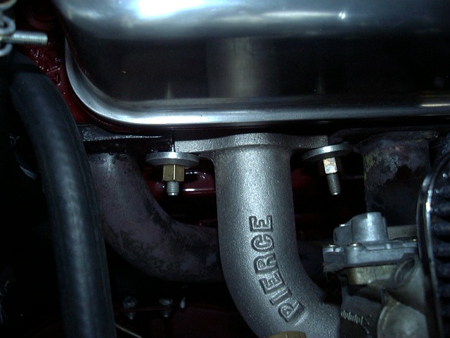

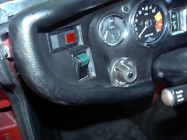

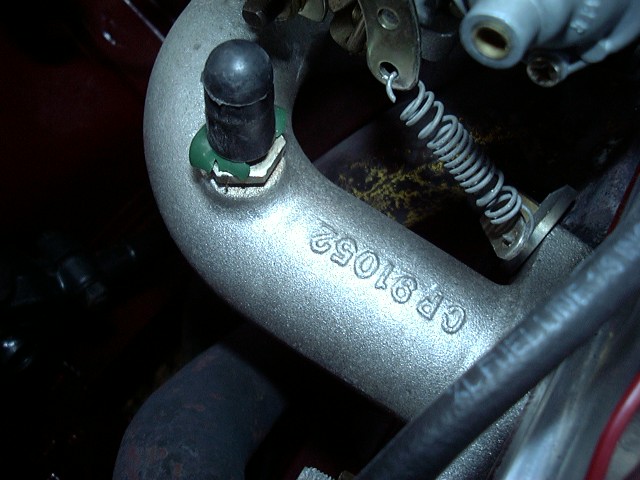

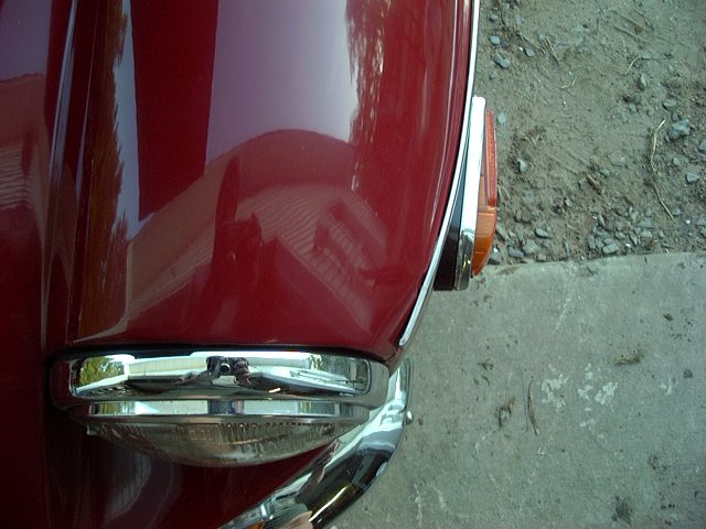

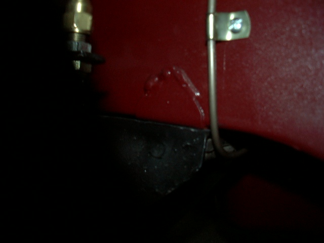

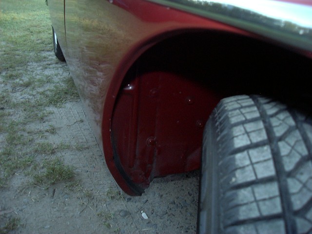

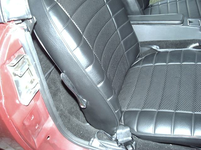

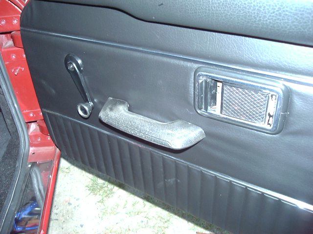

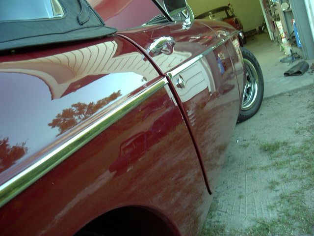

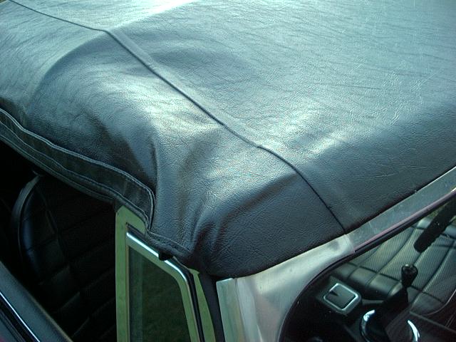

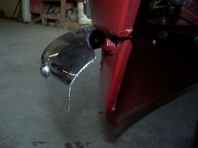

Here is a 73 i picked up yesterday.If you go to Hemmings motor news on line you will see it listed in Mereteth NH. See if you think the add matches the car! The body is not straight and i will try to post pics of that later. I can not believe anyone could screw up just about everything on one car. Manifold thickness,headlight inner retainer spring as a throttle return spring,one door armrest correct and the other is pictured,seat backs are not on the correct sides,headlight switch is off but looks on, top fit....yea thats a joke,door fit? another joke. The rear wiring harness does not go under the car for some reason. How about the steel brake line flopping less than 1/2 inch from the crank pulley! The front fender patch panels are horrable and the driver side rocker panel is loose at the bottom-poor attempt at welding. I guess if you want to lower a MGB just put the both front crossmember pads on the bottom of the unit and not between the x-member and the body! Why did i not think of that? I will try to post a pic of the appraisal. Its just as OFF as the car! Its really worth looking up the add before commenting. The list of poor workmanship will get longer once i really did into it. The appraisal says the original engine and trans are rebuilt! It was pumping oil out the dipstick tube! I guess i better get back in the garage. I have a major project ahead of me. Bob

Well I won't be nasty or sarcastic, but I do hope you didn't put $13,000 into that car.
If I know you, it will be better than new in short time.
You do have a project, so get to work young man.
Dave :savewave:
P.S. "GOOD LUCK"
Professional frame off restoration? Wow. Bob, I think I'd get another appraiser. It's a shame that you bought a bunch of unanticipated work. Hope you can recover your investment. PJ
I did not purchase the car from the add in Hemmings. I am mainly posting this so people will be aware of this sort of dealings.I guess its a good thing the original builder or seller sold the car. We do not need these kind of people in the MG hobby. Plus the appraiser should quit if he is blind! He listed ALL parts of the car as EXCELLENT! I will try to get a pic of that up today. I believe the owner had more than 13 large in the car. But a unsafe car thats misrepresented is uncalled for. I wish everyone on this board could see this mess in person. Bob
Looks like it has one of those QUALITY Moss repro bumpers I keep hearing about on this board.

I have been tinkering on it and the front engine side cover is plugged. That would explain the oil being pumped out of the dipstick tube. The throttle cable bracket was bent 180 degrees from where it should be.That may be why the heavy throttle return spring was being used. I am pointing out the botch job stuff as I come across them. In all my years working on British cars this is the worst put together car i have come across. Its mostly just stupid stuff. If you do one side each way at least you would get one side correct!??? That would explain the mirror base and the interior handle.

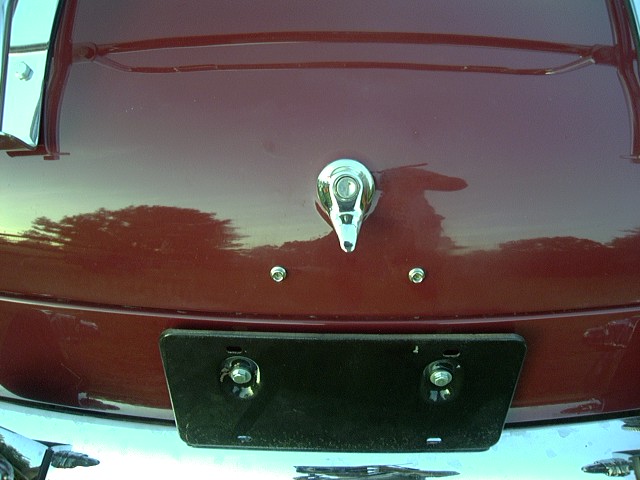

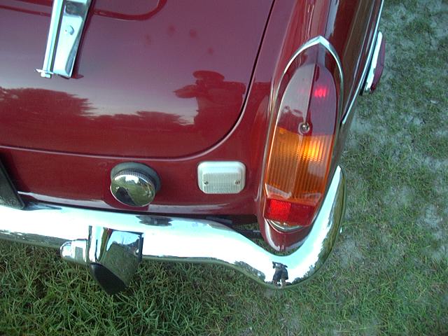

Would be interesting to learn why the 2 snaps are on the trunk lid.

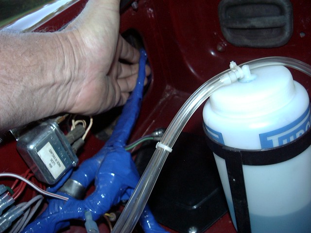

Is the wiring harness under all that blue tape any good?
How much of the body problems are you gonna tackle?

Tony, i would guess the 2 rear snaps were to fill in holes for a old dealer badge and forgotten when painting. The wiring harness looks like it may be new. I have a reciept for blue tape also. Thats probably how he rerouted the rear harness and blended it in. I am still wondering about the body. Its very presentable at 40 feet. I may just make it safe and send it away. It has a peco LCB header and peco big bore exhaust. I would have expected el-cheapo headers and exhaust. The timing was set at 2 degrees after TDC. I have set it at 10 BTDC and think that may help it go. The tie rod end jamb nuts were also loose! OH.. the sucker also has a larger front sway bar. Bob

Those doors....from the photo, almost looks like the wrong door seals simply preventing full closure?

Today i installed the crossmember pads and removed the seats I was going to just reverse them to the proper sides. The lower material was not glued to the foam so there was no shape to the seats. When i removed the covers i discovered that the lower foam was installed on the wrong seat and did not match the covers. So swap the foam-glue the botoms covers and reinstall on the frames. While i was under the car i noticed the slave cyl had the flex hose in the wrong port. The distributor clamp is on upside down,One seat belt is installed odd and there is silicone brake fluid leaking from the junction block. That explains the reason the fluid was very low in the brake master. I can't wait to get to the rear of the car! Bob

I noticed in the pics that it has two driver seats in it...I think I saw another post on here recenty that said that his car had two passenger seats. Maybe find him to trade? Good Luck with this one!
Bruce
Bruce, There are a real pair of seats in the car. Someone just got their lefts and rights installed on the wrong sides. I emailed the original seller in New Hampshire requesting information on the car and have not heard back yet. In the stack of bills there are no engine parts listed except gaskets and accessories like the carb and alt. and valve cover. The appraisal says rebuilt engine. The brake lights are hooked up to the running light bulbs and the signals are hooked to the brake light bulbs in the rear. I have not tried the signals yet. Maybe the horn will blow when i use the signals! More as i dig deeper into this car. Bob
