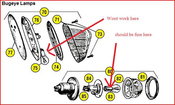

Check the orintation of the bulb socket that your going to use. 1157's shine in all directions those are kind of like a flashlight concentrated beam.

I did it, got them from a website called superbrightleds.com This site is great because you can get full mechanical drawings and specs of the bulbs to be sure that they will fit your application.
