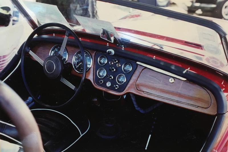

Here's a photo of a wood dash that I took 25 or 30 years ago at a show. Nice, straight grain wood, and not over-the-top ornate the way so many wood dashes are. Very understated and Morgan-like.
