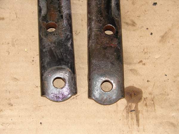

Well I managed to get everything apart on the front end so I could change the bushes. Here is a of picture of the wishbone A arms. Only one is a little bit worn. Should I replace it? Or the pair on that side? Or all four? I'm retired living on a fixed income but seeing as I have everything apart I think I should do it right.

The one on the left is toast - replace it with either a good, used one or new.....the one on right is good to go.
Never ever skimp on parts. Yep, do it right the first time and you will never do it again. Take your time.
