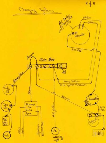

This is how I did it:
https://www.healey6.com/Technical/Alternator1.pdf
Here is a diagram of the circuit I built into my BJ7. The "Main Bus" in the wiring diagram is the location of where the voltage regulator used to be. You can either remove the regulator and use a terminal strip as I did or you can cut all the connections to the regulator terminals on the back of the regulator. I figured why ruin a good regulator and I wasn't trying to fool anyone with my alterations. Simple is best to me. So I used the terminal strip.
A couple exceptions to the wiring diagram is that (1) don't bother to put in an amp meter. It won't record properly as I have it anyway. Just run the #10 red wire from the alternator "B" terminal to the "Battery" terminal on the starter solenoid. That gives you a much heavier wire for the charging current from the alternator to the battery.
Exception (2) is that I believe I mislabled the wire on the alternator marked 'R' or on some alternators it is marked '1". On my drawing it shows as yellow/brown I pretty sure it is really a yellow/green wire. Steveg above mentioned it as yellow/green and I go with that. (i really should change my drawing). As you can see at the regulator location where i use a terminal bar (main bus) this yellow/green wire is attached to the small yellow wire which goes to the ignition charge indicator light.

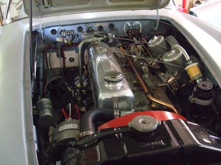

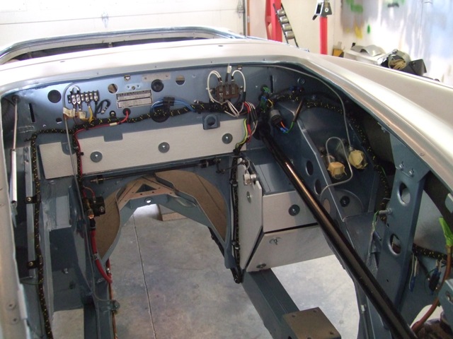

I have also attached two pics of my engine bay for you to see what the connections at the voltage regulator location look like in real life. I believe the pic a clear enough that you can pick out the wire colours there also. this wiring has been working in my BJ7 for 4 years now.
