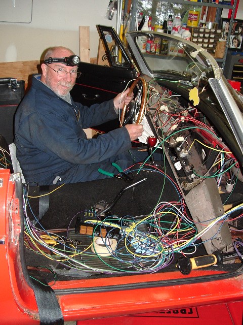

Next time I'll be more precise. In the meantime, here's my harness experience

Holy mackerel! I thought someone dropped a plate of spaghetti in the car!
. Wow, that's a lot of work doing it that way. Going to be nice when it's done though. The only thing I'd do different the next time is pull the steering column. The darn thing is always in the way. Not that hard to pull and I think it'll be worth the effort.
NEXT TIME????????????????
Paul, thanks for offering to drive up and pull the column, I'll try to give you enough notice.
The job is done and it really is a nice set up, but the GT6 is next and that will be done with the column and engine out and it will be a standard replacement harness as Dan doesn't make a harness for the Gt.
You can "chase" the GT harness, Mike!
Your "baptism by fire" is evident in th' photo. :jester:
