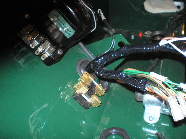

When I see topics that I feel will be of future interest to me I transfer the info into one of my BCF Tips files. I did that last year and the subject was installing the wiring harness. The question was how do you get all those wires into the little rubber grommet.
Don Elliot answered with the notion of putting the wire through the grommet and THEN putting the grommet into the bulkhead. I must say that it worked slicker than goose grease, er Lithium grease actually. Thanks Don!
