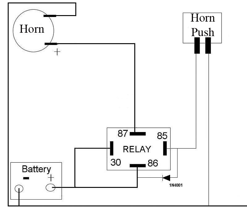

NO Momentary button switch, relay, and horn that the mower battery will power. That should be all you need.
You must have a very quiet mower to need a horn! :D
Simple diagram! (You can omit the relay, but it's not a good idea.)
I don't think the diode belongs in that diagram either.
Some automotive type horn circuits (like on the MGB's) have the horn always hooked to battery + and the button connects the other side to ground.
