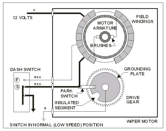

To answer your original question, I don't think you can use the TR6 motor, at least without some major modifications. It's hard to tell from the wiring diagrams, as they don't show enough, but here's what I think is happening:
The TR250 motor appears to be two-speed, where the speed is selected by grounding one of two terminals through the switch.
The TR6 motor seems to be three-speed, and speed is selected by powering one of three terminals, not grounding it.
The final wire is just the positive voltage to the motor.
So, they seem to be fundamentally different. The only way it would work, I think, is to disconnect the ground from your switch and run the +12V to that switch terminal--then you could power two of the three speeds. But this sounds like more than you want to get into, and it all depends on whether my assumptions about what's in those boxes marked "switch" are correct.
But I also agree that it's likely the problem is in the cable.
Any difference in the look of the 2 switches.
Can the 6 switch be put in the 4's spot?
Well, how important is the self-parking feature to you? Would you be willing to add a relay and some diodes to the circuit?
Both motors are two-speed motors, but the speeds are implemented differently. The TR250 motor used a wound field and achieved the two speeds by switching the field windings. That allowed a very simple "ground this wire" park switch, and no support from the control on the dash.
The TR6 motor went to a (less expensive) permanent magnet motor, which of course means the field is fixed. It achieves the second speed by using a third brush, which effectively bypasses a couple of windings on the armature. But since it can't have both brushes connected at the same time, the park circuit got more complicated and basically the dash switch has to make a connection in the 'Off' position that the TR250 switch doesn't have.
So, to use the TR6 motor with the TR250 switch, you'll have to either give up on the self-parking feature, or add a relay to complete the circuit through the park switch when the dash switch is 'Off'.

PS, here is a diagram (also by Dan Masters I believe but I forgot to record where I found it), showing the TR250 wiring:
