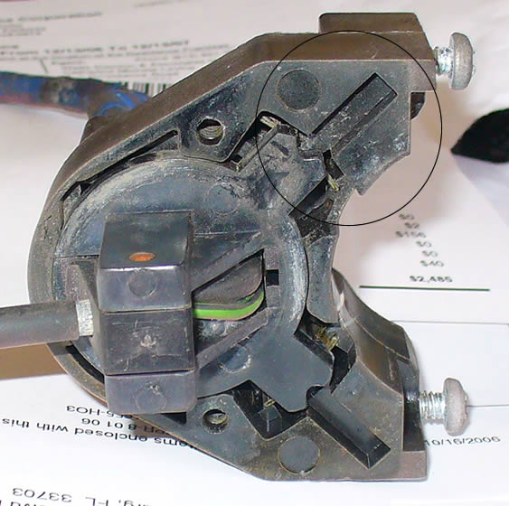

the wiper arm "seems" like it will work, you can move it to the 3 positions (off, low and high). but the clicks do not seem like they are strong enough.
are there supposed to be some kind of springs in the slots that help snap the lever in place?
if so, where do i get them (tony?)

That poor thing's missin' all-sorts: springs/detents, looks like contacts missing.... mebbe Tony's got a good used one.
Colonel?!?!
Hmmm, think I saw those in a big plastic box in the white outbuilding.
Yep, that thing's been gutted - contact me off-BBS.
