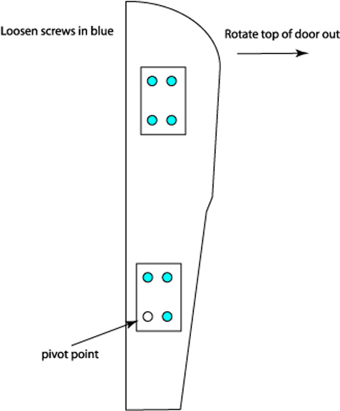

Just a crazy thought Jim. How would moving the top of the door outward look? If you loosened all the hinge screws except the inner bottom (remove all shims you added), then rotate the top outboard slightly (see attached diagram) That might get you what you need for the door-to-windshield post clearance. Double check that the door doesn't hang out from the fender. Maybe even shim the fender out slightly, the fender bead may hide the sin.

Good ideas, guys. As soon as this episode of The Sopranos is over, I'll sneak out to the shop to play for a few minutes. More tomorrow. Thanks so much.
