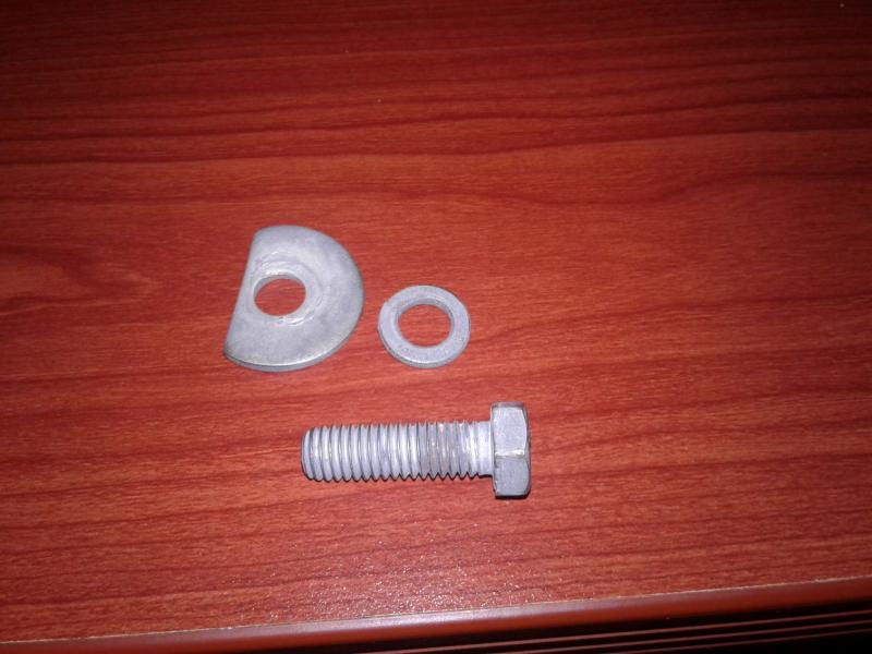

JP, those windshield bolts are 3/8 course thread.
Here's a pic of one of them I just took out last week. Flat nose, no taper, 3/8 coarse thread.

thanks! It has been a while since I did mine (Midget) but I hadn't realized it was Course thread - good to know! and still a great idea the bolts.
