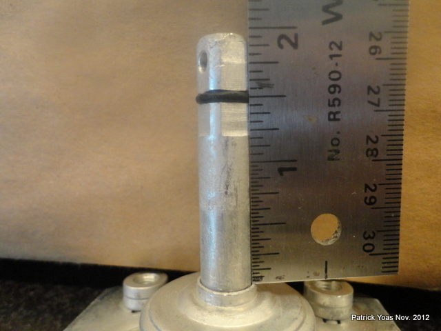

Here's photo of my BJ8 Window Crank unit with ruler for measurement of stem length.

Here's photo of my BJ8 Window Crank unit with ruler for measurement of stem length. [/QUOTE]
Thanks Patrick. Is that a rubber O-ring? My stem does not having anything like that on it. Maybe that's why my gas mileage sucks.
Thanks Patrick. Is that a rubber O-ring? My stem does not having anything like that on it. Maybe that's why my gas mileage sucks. [/quote]Yes, it's an "O" ring. It's an old trick I learned from one of those old car magazine ad's claiming to increase milage.
I also increased my HP by 50% by changing the distributor mechanical advance springs too.
--------------Keoke-- :lol:

Interesting. Patrick shows his BJ8 to be about 2"
Patrick, did that come off one of the mid year BJ7-BJ8 cars, being the shaft length is between 1 1/2" - 2 1/2" ?...lol
AUSMHLY said:
Seriously, am I missing the o-ring? What is it's purpose?
The O-ring makes a snug fit for the window crank and stem to keep them from rattling(like we really can tell a rattle in a Healey?). They really do work! Let me know of you need to know the correct size to buy?
I really think the measurement is where a person takes his measurement from. I did it the easy way because I didn't think you wanted to dismantle the unit to get the overall size. I hope where I took it from is good enough.
I think my car is midyear if you consider that new cars come out in the Fall and mine was built in March '67. VIN-40928
