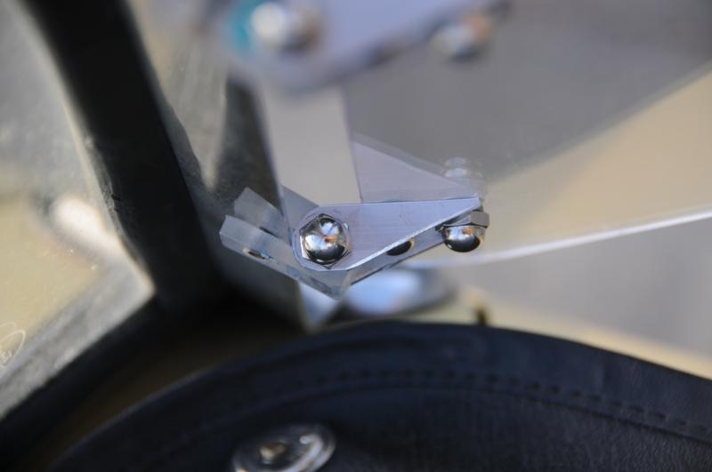

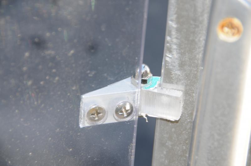

59diamond - I'll take a couple of pictures of the hinge setup that Alan uses - it's based on a bit of Lexan and an Allen headed machine screw.

Enclosed are two pictures showing the approach that Alan Fisher has taken. The piece holding the windwing itself appears to be U channel aluminum cut at an angle and through bolted the Lexan; the hinge is locknutted bolt, and the piece holding the wind wing to the screen is a piece of thicker lexan with a saw cut allowing it to be slid over the windscreen flange and with an allen headed machine screw clamping onto the windscreen. Doug
I guess you could talk to Alan, or fabricate them yourself. I expect that there's something equivalent commercially available out there, but finding the pieces might take a bit of a search. Doug

I just measured the aluminum 'U' channel that Alan used (in case anyone wishes to fabricate their own mounts) and it's 5/8" wide, and a bit less than 1/16" thick. Doug
