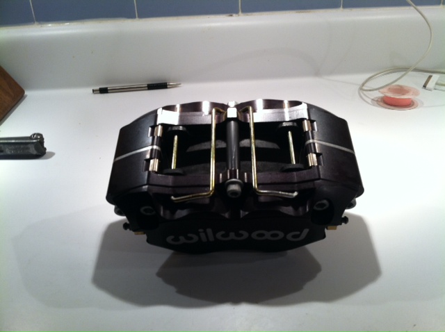

I installed the Wilwood calipers from GP back in May. Here's what he told me about piston size: "I have the front calipers with 1.38" or with 1.62" pistons. The 1.38" will provide a better front to rear balance when used with stock rear brakes but will require a little more pedal effort. The 1.62" are best used with upgraded rear brakes."
While you could source the calipers directly you'd have to do some machine work to get them to fit properly. The picture below shows what work he does to get them to fit.
I kind of assume it wasnt a direct bolt up and that some machining has been done on them. and I did go with the larger size piston and the upgraded rear wheel cylinders, shouldnt be too hard a job, I figure getting the old sub axle out will be the hardest part

the calipers have arrived, the uprated axles and timkin bearings will be here today
