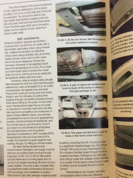

ISTR seeing a photo of an oil pan with a section added and tubes open at the ends running through the pan lengthwise to provide additional cooling.
Revington has a system like that.
it is mentioned in Roger Williams book "How to improve Triumph TR2-4A" pg 124.

THAT'S where I saw it. I have the book on my "car" shelf.
Niel Revington makes some strong points in favor of his cooling tubes, in that chapter:
(paraphrase.) " oil coolers are unnecessary except for competitive cars & very hot climates, because they are just something else to go wrong & reduce airflow to the engine radiator. "
However I don't like the idea of cutting a large port in the crosspiece for flow thru air. Installing a duct system below the cross piece further reduces your ground clearance. So it seems like this is a simple problem with a not so simple solution.
