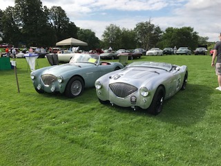

IN the process of helping a friend restore a basket case BN2 to an all alloy body racer (attached picture with my 100M at Pittsburgh Vintage Grand Prix). We are not going to reinstall the heater for now so need to blank off the heater hose connections to the block which are Whitworth. Any body have a favorite source of Whitworth hardware they'd recommend? 100 PVGP 2107 2.JPG
