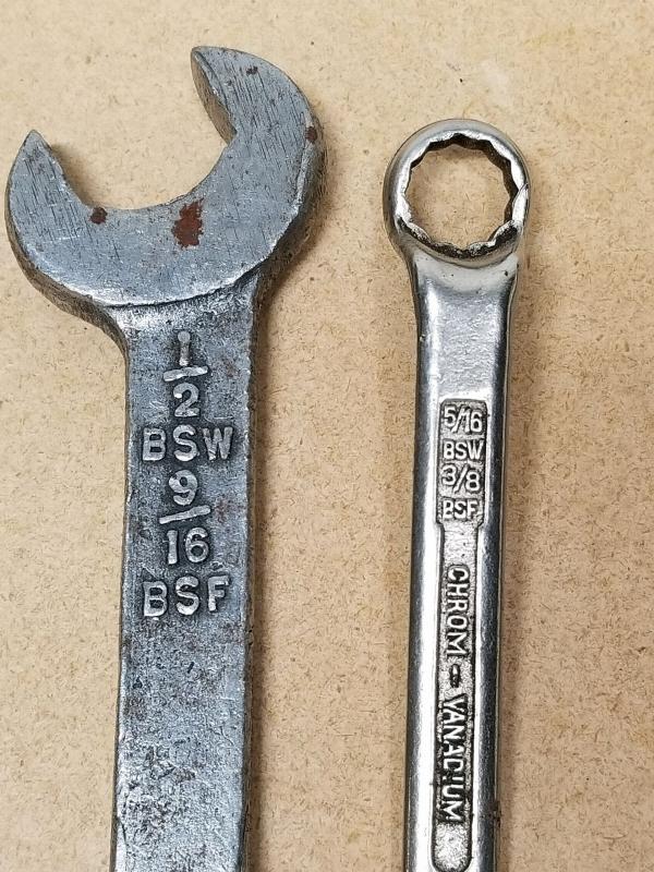

Those appear to be Whitworth only. Fine thread were BSF, coarse thread BSW.
British Standard Fine and Whitworth. Most cars, engines, motorbikes etc., had more BSF than Whitworth threads. Head sizes were suitable for Whitworth tools, many are marked with 2 sizes, like 1/4 W, 5/16 BSF.
BA is another thread form, found in electrics and occasionally carburetters.The one I like is a big one marked OBA - whatever that is. I think I used it once. Don't try to cheat if you don't have Whitworth wrenches. Ever skin your knuckles when the wrench slips? I would never use an open-end wrench if I could avoid it.
