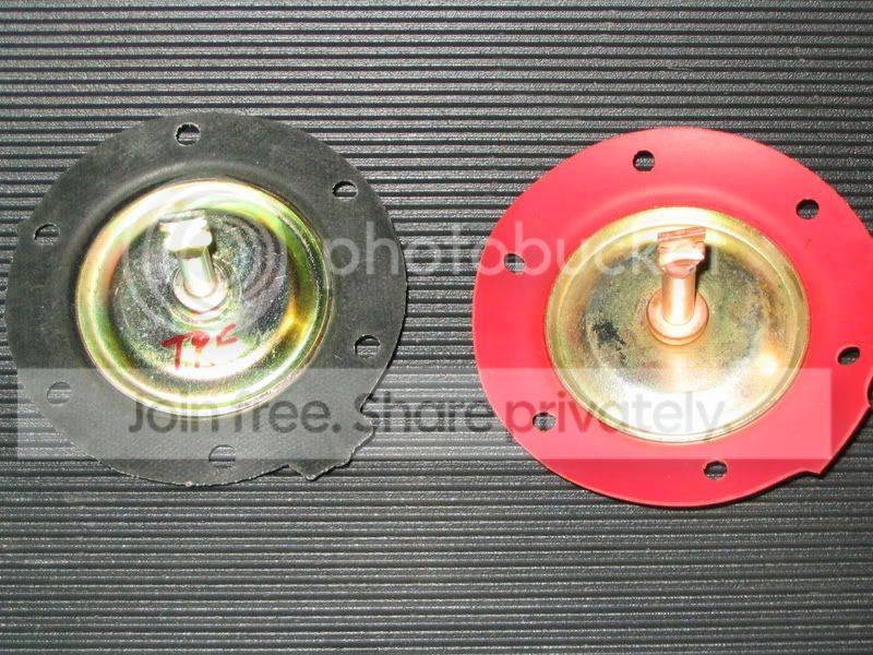

Which would you use.....
mrv8q
... or does it matter?
These are for my suspect TR3 fuel pump. The black's from the TRF kit, the red from the Moss kit. My fuel pump is suspiciously covered in crud, and I think I'm smelling gas when checking the oil, so I'll change the diaphragm and oil at the same time. (Well, not at the same time, but you know what I mean.
FWIW, the Moss kit was for the TR6 fuel pump, but I found the 2 small valves impossible to put in; I wound up using the perfect fitting TRF valves. Sometimes it pays to have a few extras laying about.

The short answer is that I had two of the red ones from Moss and both failed within an hour or so. It seems the ethanol in the modern gas eats through them. Both had the same failure mode and that was for the red rubbery material to disolve and fuel got through to the oil sump, and the pump could not deliver fuel any more. Cost me a lot of oil and filters.
I tried a third one from a local vender and it also failed. I have not tried TRF one yet. I ended up putting a replacement filter on the car but winter and snow came before I could get many miles on the car, and I am avoiding gas formulated with ethanol.

Thankfully, the "crud" is completely external. I'm guessing a slight leak, and dust/dirt has stuck to the outside of the pump....
Looks like I'll try the TRF diaphragm, thanks for the heads up!
