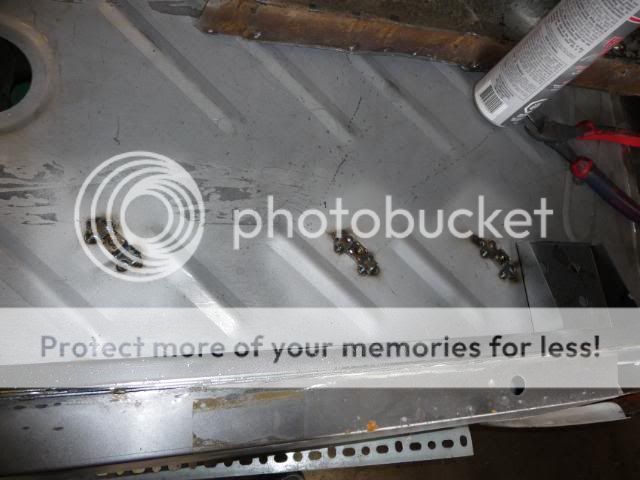

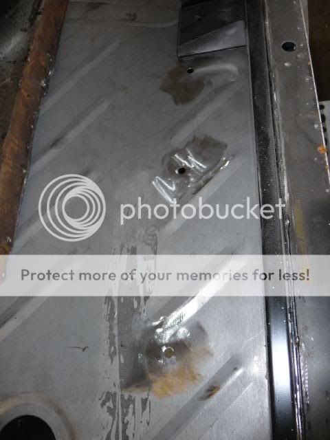

I bought mine from Moss. They fit ok but be pre-warned that you will need to buy and weld on all the captive nuts on the bottom of the floor pans as the Moss ones do not come with them. I think that the TRF ones might. It may sound trivial, but I bought the new cage nuts from Macy's and I think that they were about 1.50 each including shipping. Off the top of my head, I think that there were at least 18-20 required to be welded on. So, an additional $30 bucks plus your materials/labour to weld the cage nuts on.
Cheers,
M. Pied Lourd
Here are a couple of pics.
Cheers,
M. Pied Lourd
Attaching the cage nuts.
Weld Through Primer
Cheers,
M. Pied Lourd

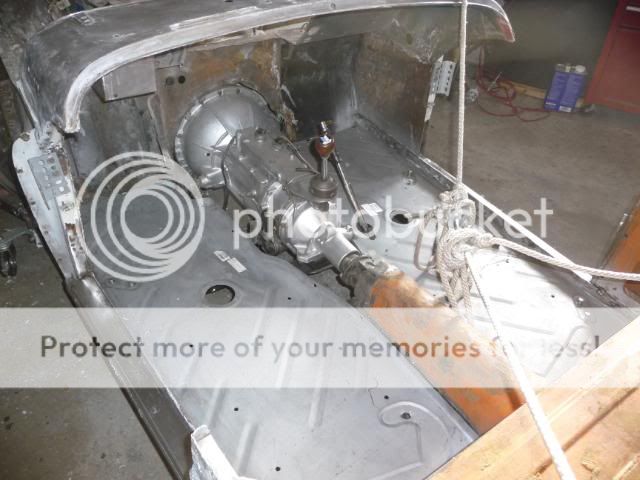

Got mine from london_classics (ebay uk). The capture nuts are welded on and the quality is good. The exchange rate at the time was very good, so the net was better than any one here in the US.
Get some pictures up of your progress Gordon...
They look the same as mine. The exchange rate and shipping made them a good choice.
Paul
