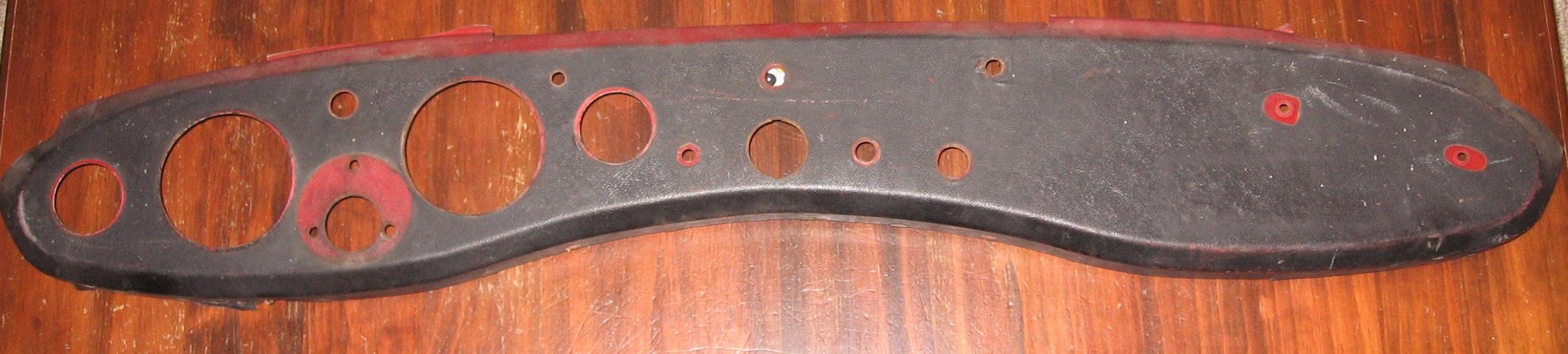

Hi Drew,
Just been across to the workshop in -15 to get my Bugeye dash. Its a 100% stock LH dash with no extra holes. Only the wiper pull switch and indicator switch are D shaped, and the Ignition combo switch has notches top and bottom to orientate switch and stop rotation of the body. The choke,starter and heater switch are all round holes. Can take a pic if you want.
Cheers
Lew

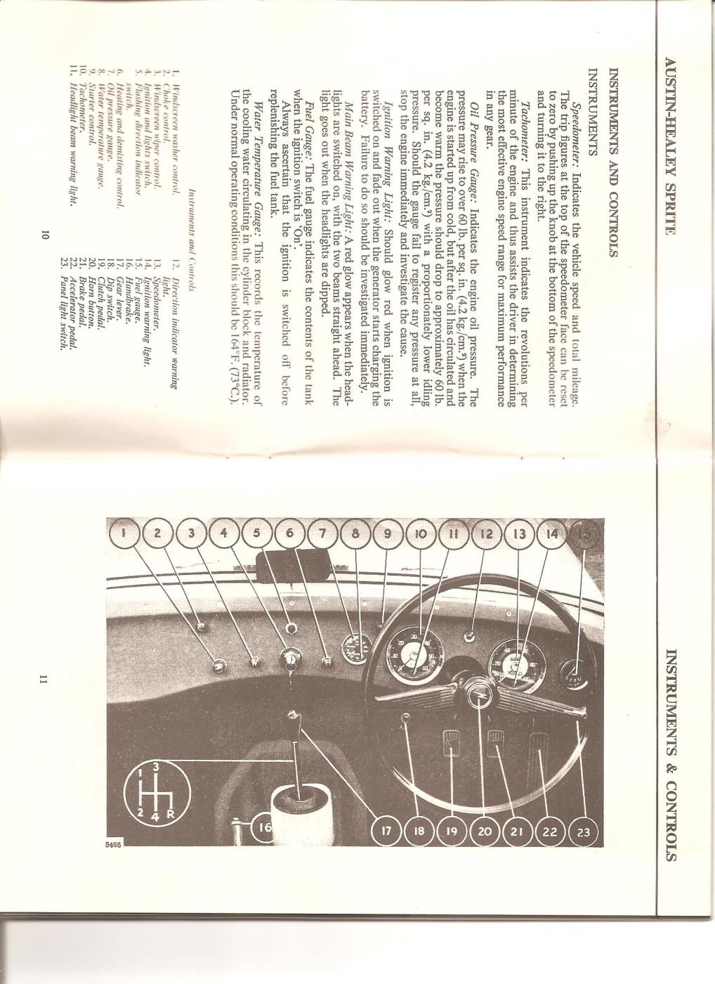

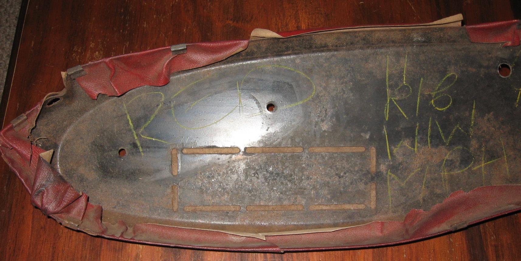

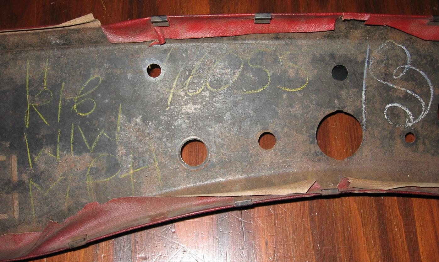

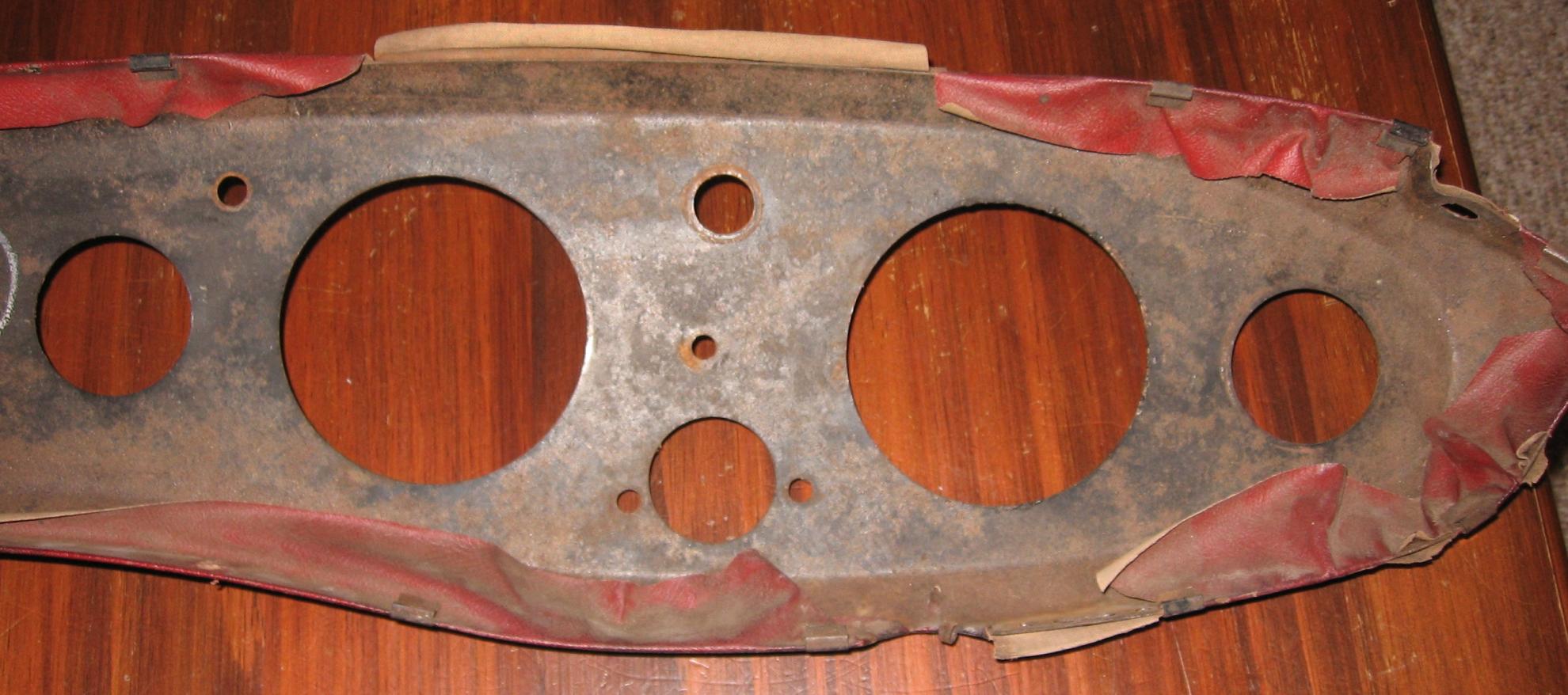

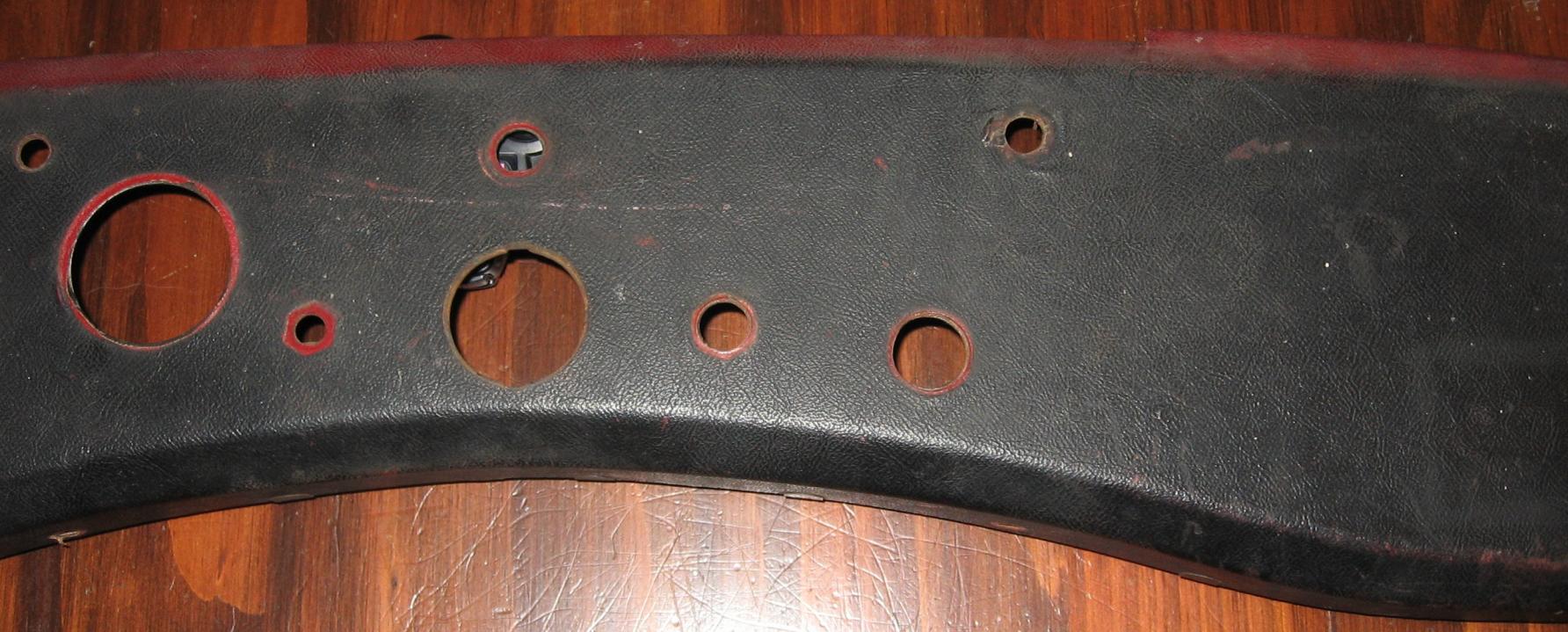

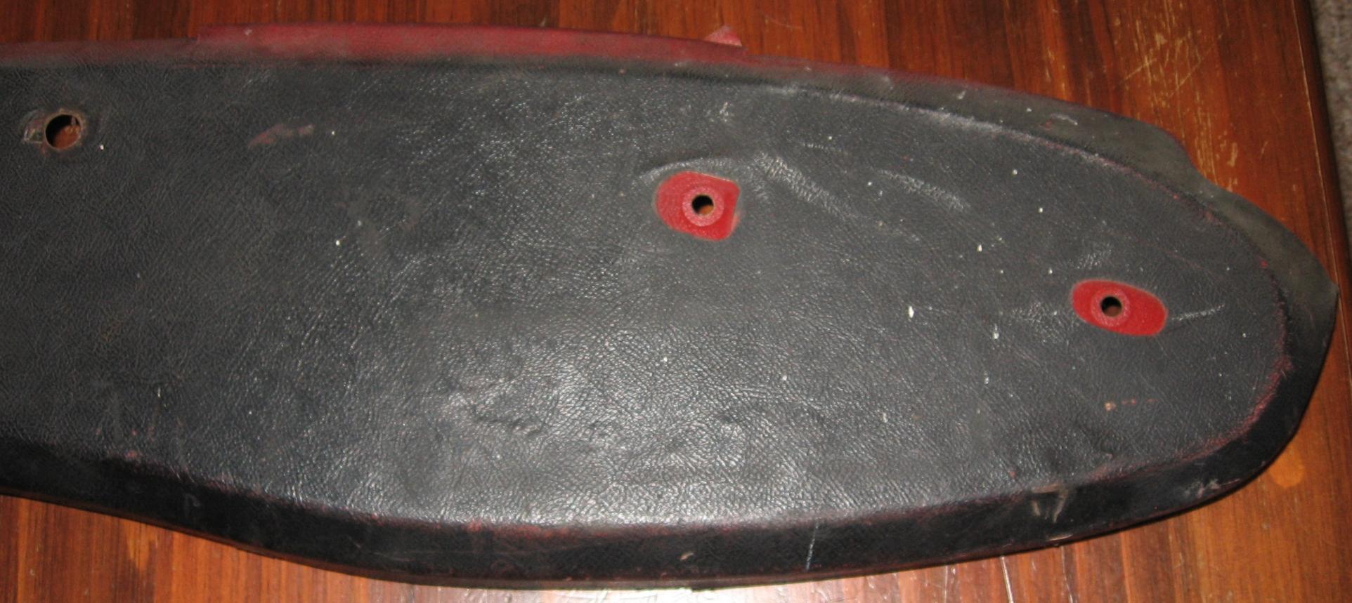

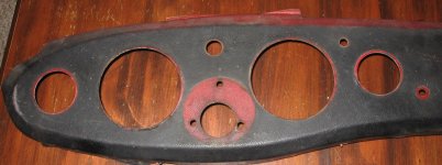

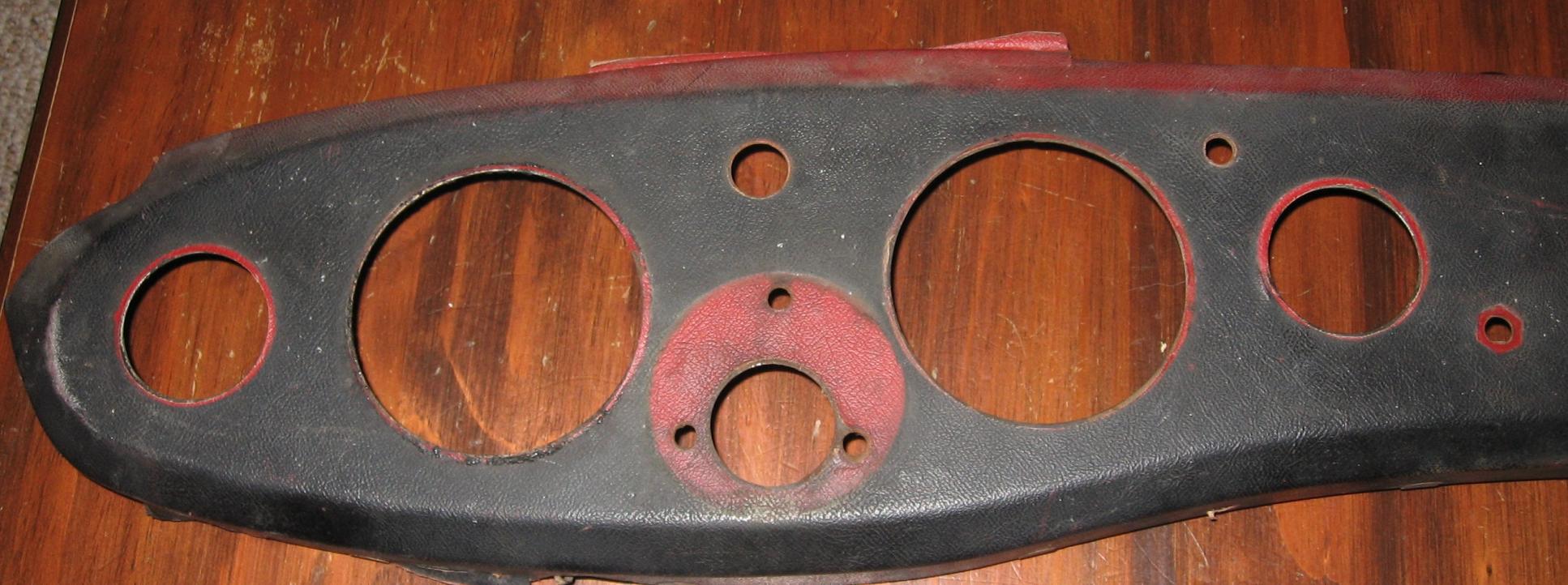

Here is the layout of the dash from the RHD handbook and several pics of my dash, with original 50 year old chalk markings on the back. This dash was obviously red originally, stained with black vinyl paint by previous owner.
From the RHD dash, it appears that only the wiper washer pump position changes to the opposite side for a LHD. All other switch and cable locations remain the same. For the LHD setup, I assume the Tacho remians closest to center as shown in the last pic before dismantle.
I hope it helps.....
