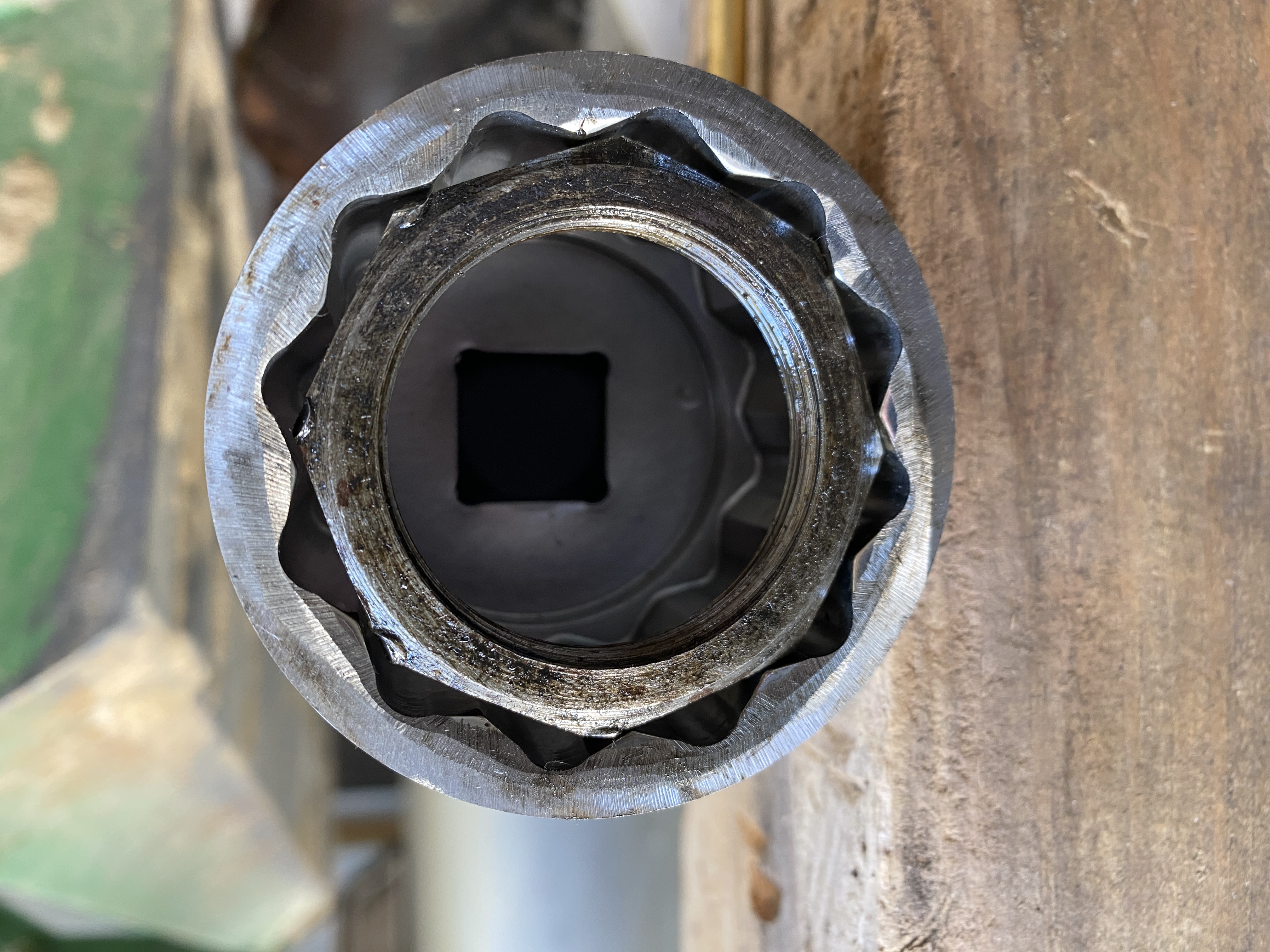

None of the local auto parts stores (I went to the 4 big ones) have the stamped steel axle nut sockets anymore. I found a couple that were way larger but that was it. So I found a Textron 12 pt 1 15/16inch socket on Amazon and ordered it. Hoping it will work. Bruce
Post the results after you receive and try it. If it's too large, PM me your address and I'll loan you my 1-7/8" socket which I mentioned earlier in this thread.
I wanted to post the result of my trying a 12 pt 1 15/16" socket I ordered. It did not fit well at all even though decimally it is the same size. I did get the nuts off but it did start rounding off the corners. I did grind the beveled surface of the socket. No way I would be able to torque this back on at over 140lbs. I am going to order one from one of the parts suppliers out there specifically for this but wanted to post the result so nobody would waste their money. Bruce
