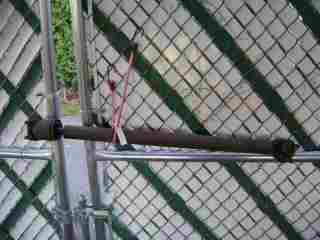

Pete,
here is a pic of my CV driveshaft

OK, terminology in the way here. Apparently the propeller shaft you have has u-joints and not CV joint(s) at both ends. Look at the picture of Don's propeller shaft.
