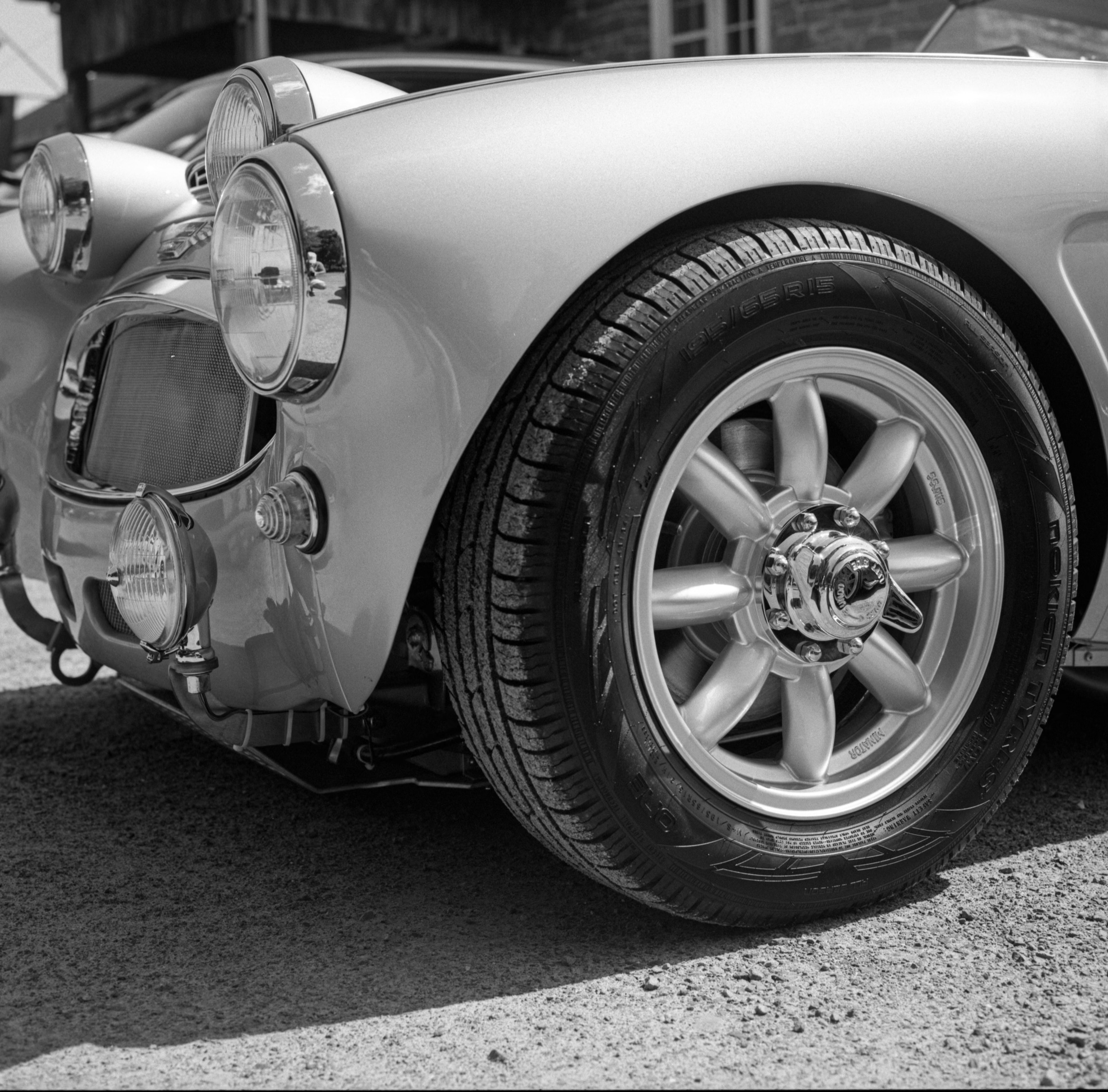

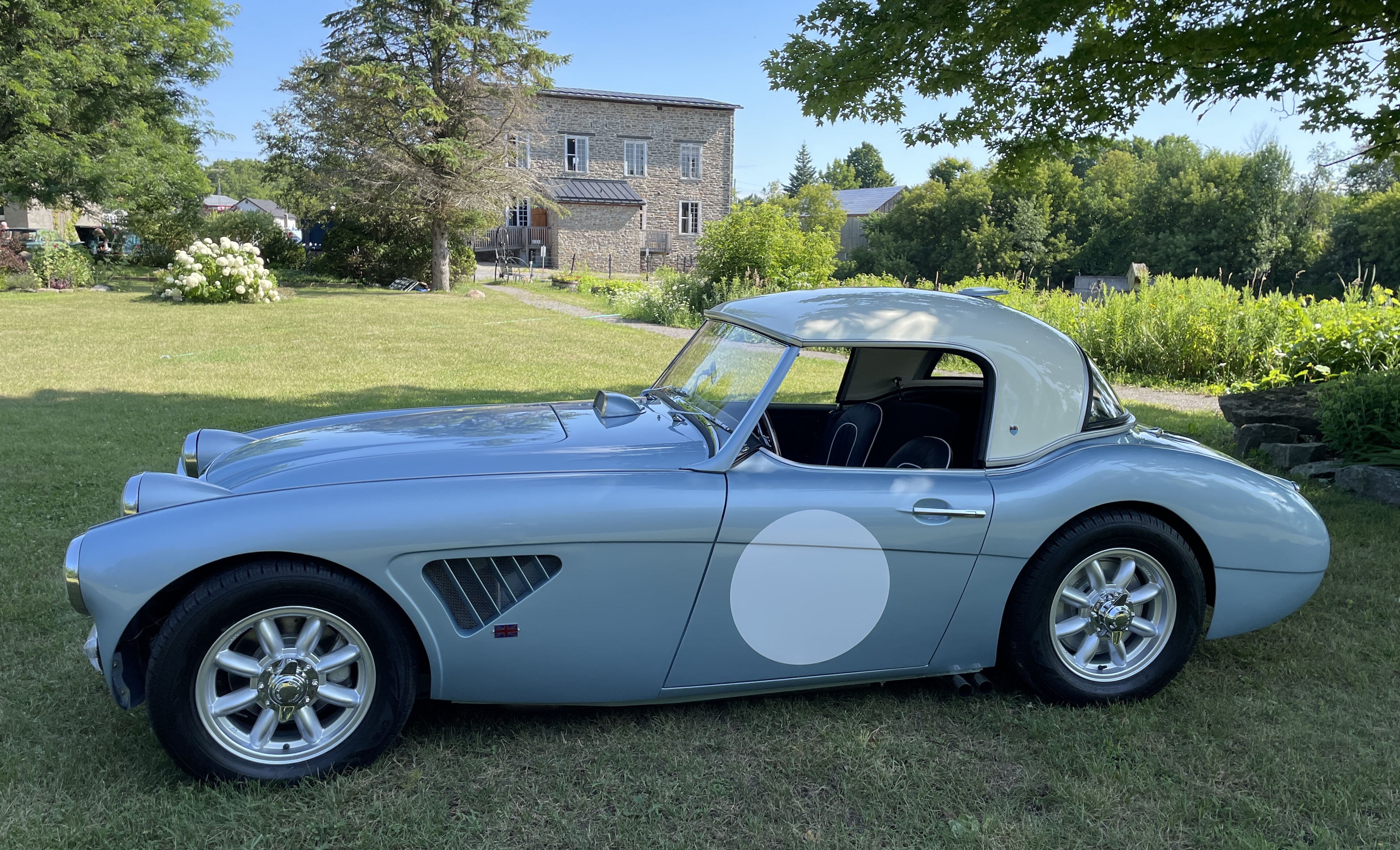

Not true if you fit wider wheels and tires to suit then the boot lid (trunk lid ) will not close ,you have to remove or reduce the wood stop block at the back to make the tire/wheel go further back in the boot (trunk)
I had 5.5” wheels on all my Healeys with 195/65 15s and had to modify the wood blocks on all of them so the boot would close correctly .

Thanks for confirming exactly what I said: "No need to chase some skinny tire." Even your rather extreme 195/65 - and don't tires that wide rub on the inner fenders? - fits in the boot with the trivial chore of modifying or removing a wood block.
No rubbing even with lowered suspension .
