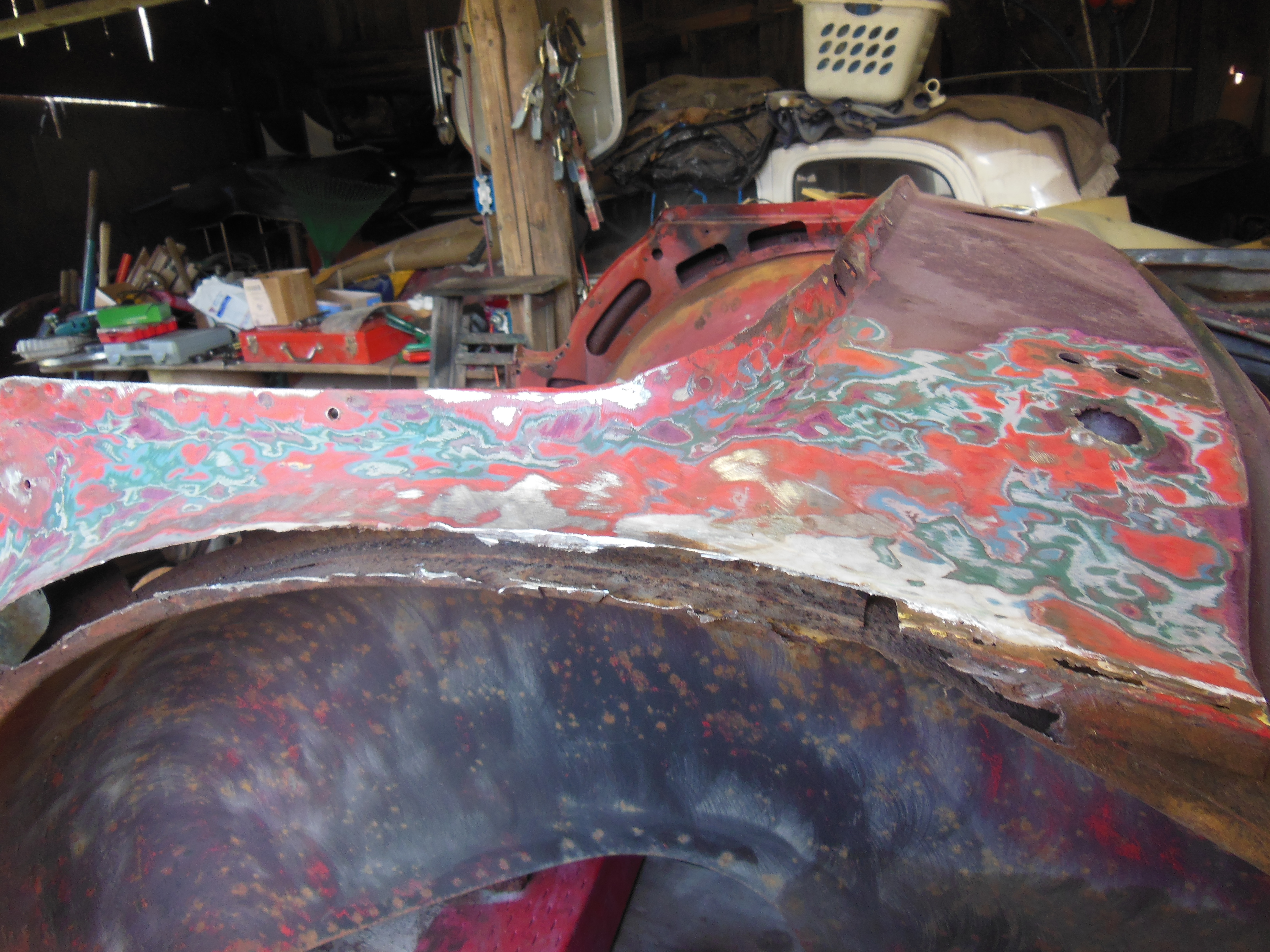

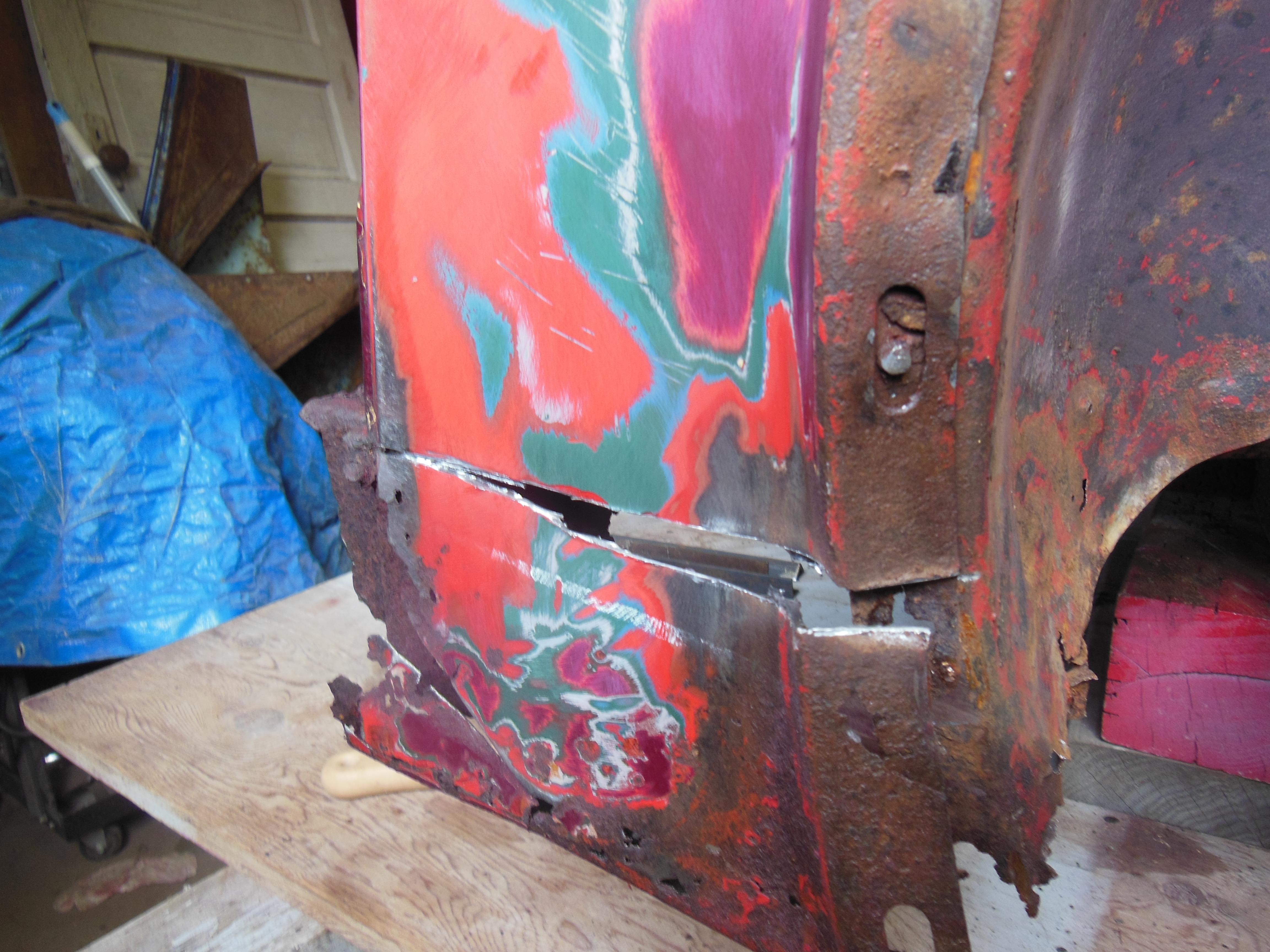

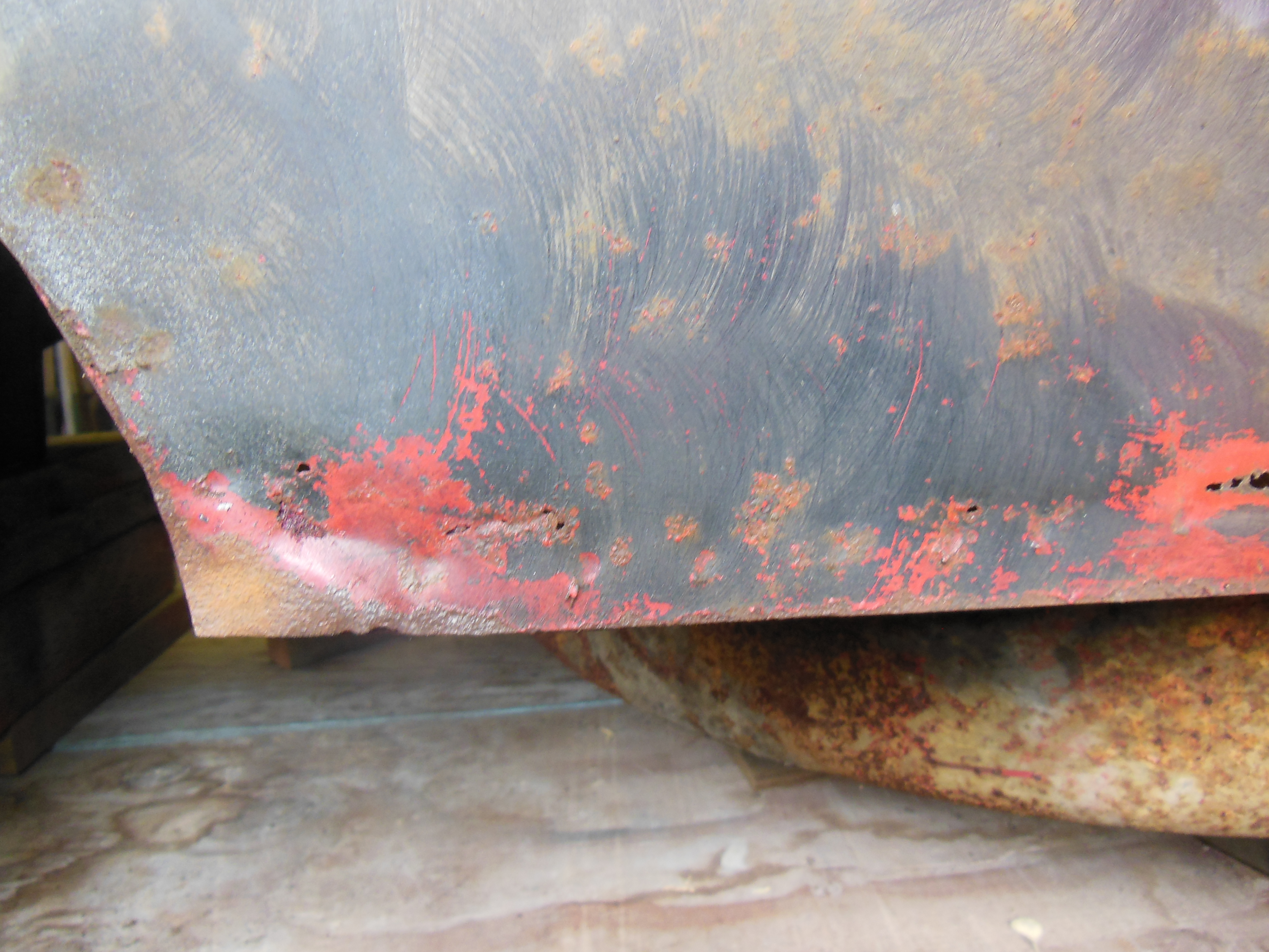

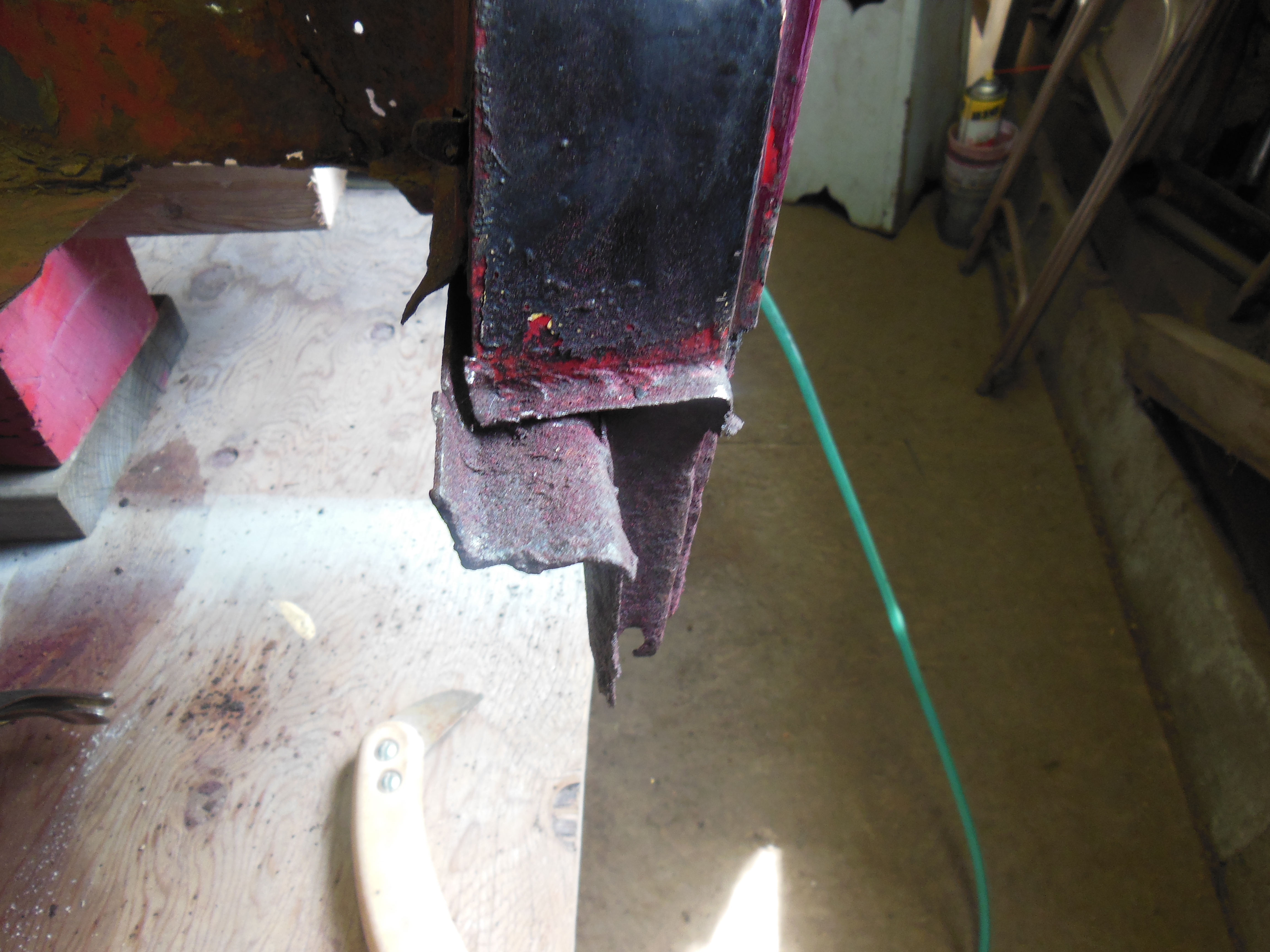

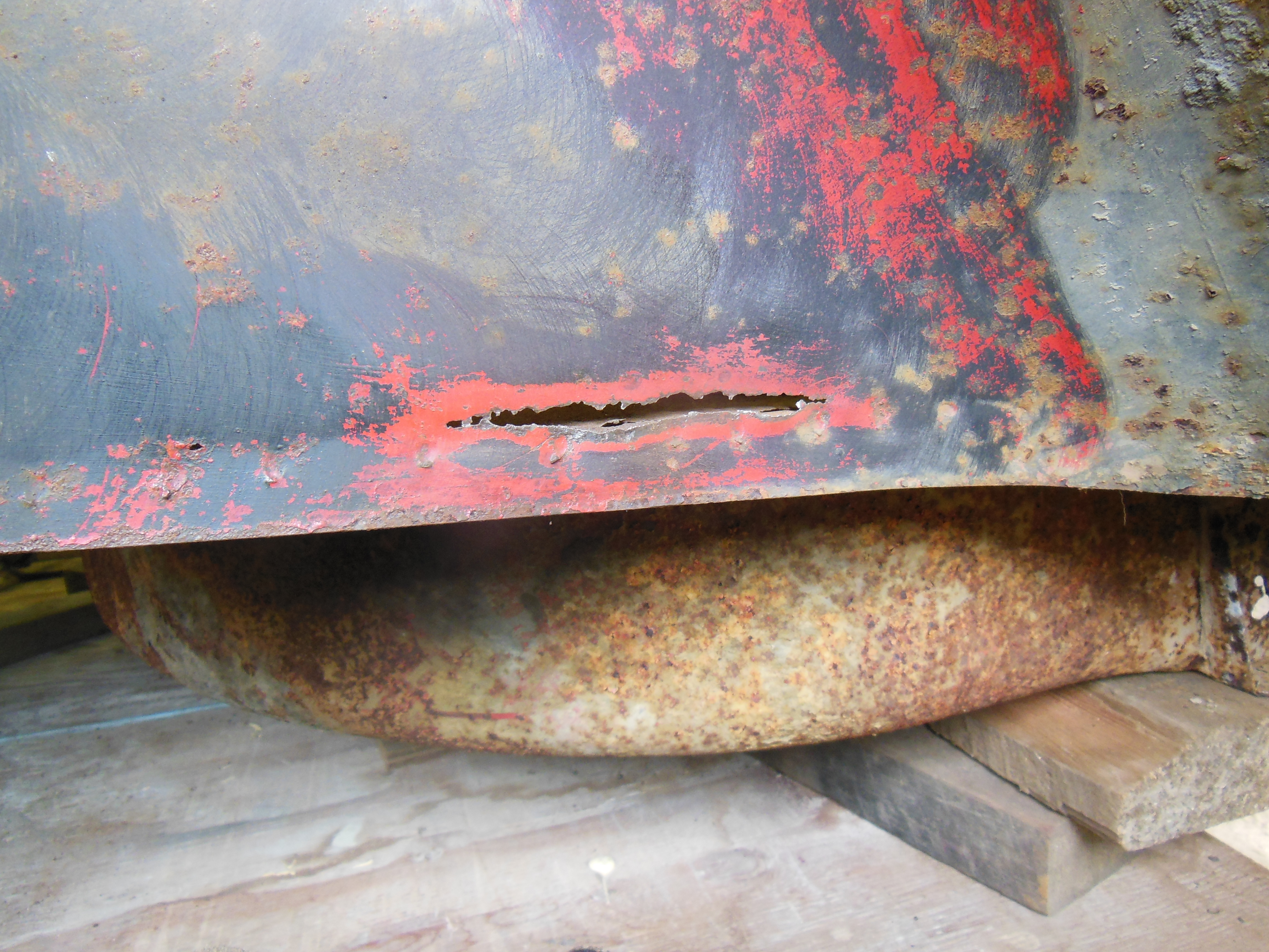

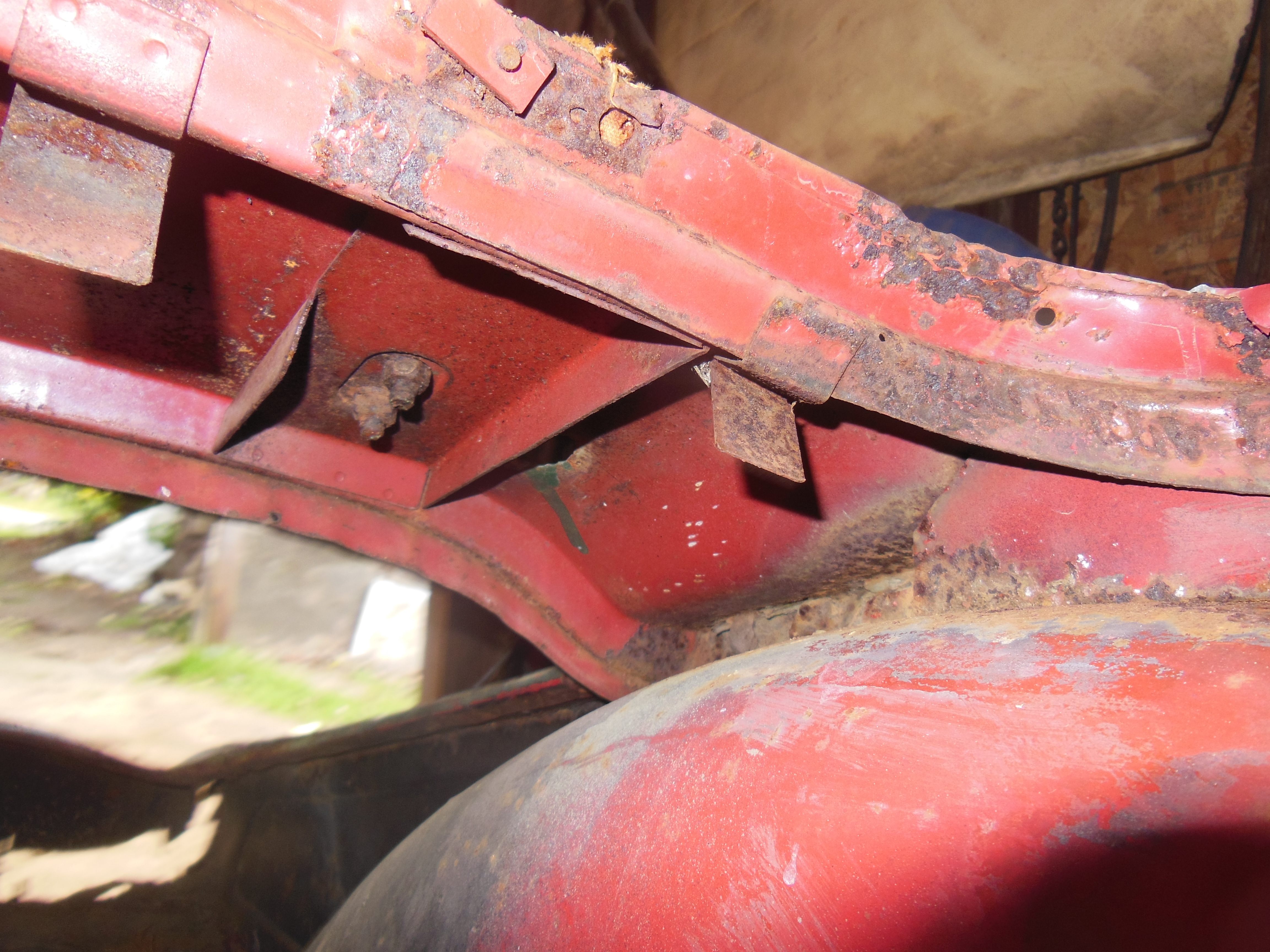

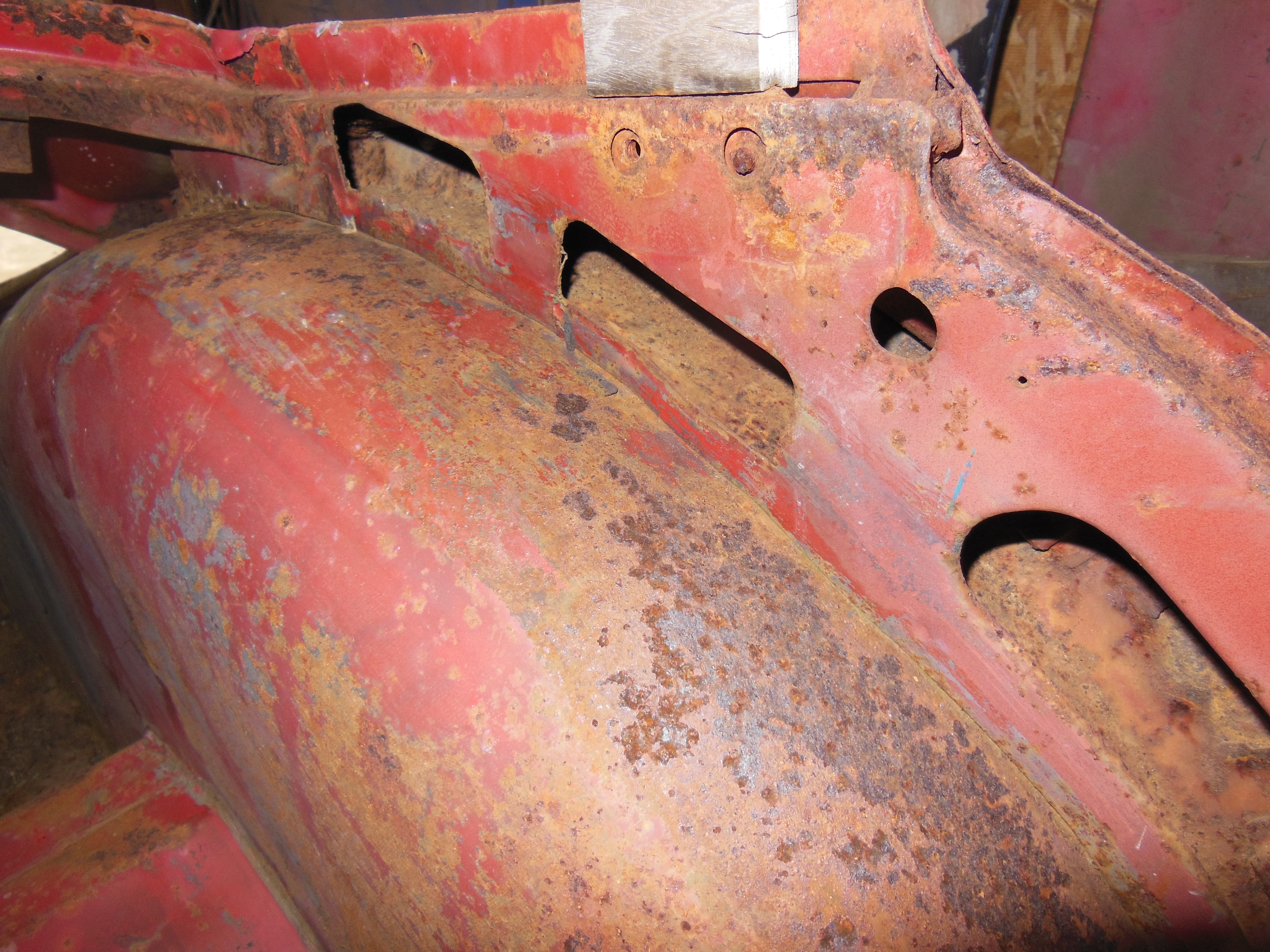

The wheel arches on this new project are in worse shape than I thought. I did not realize how the outer side of the wheel arch where the chrome beading goes is so difficult to access from the back and how structurally important the arch is. I am going to learn or shut my eyes some. I was raised with the anything worth doing should be done right theory, but here there is some ambiguity. Anyways any all suggestions are appreciated.

The photos do not appear to have rust all the way through the metal. Careful use of a sandblaster will access those back corners and hopefully give you some solid metal to treat.

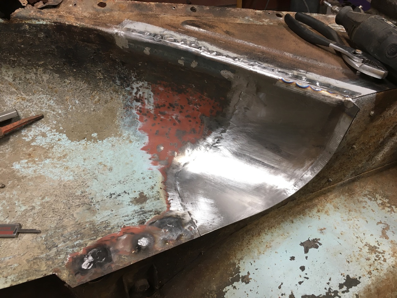

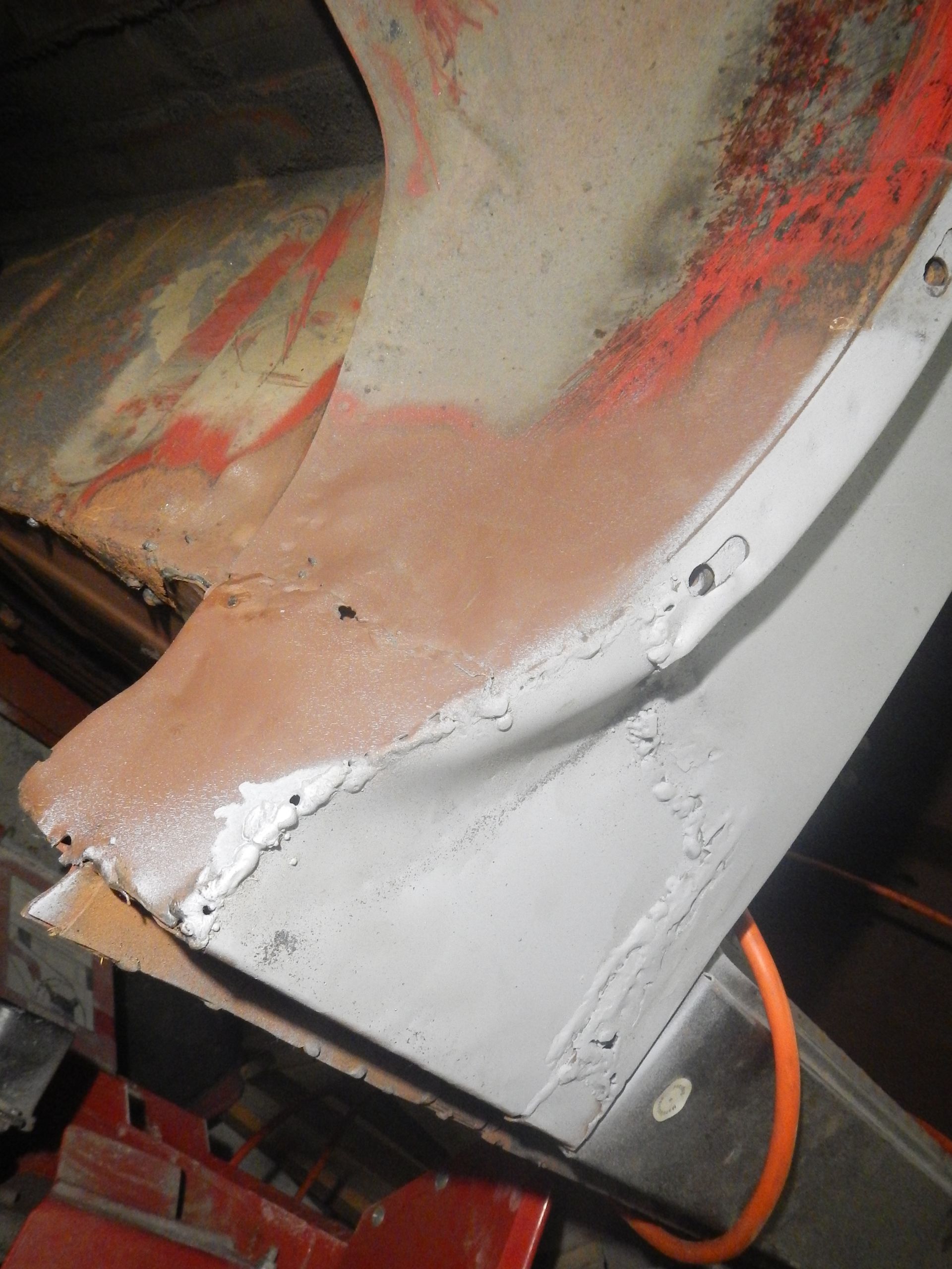

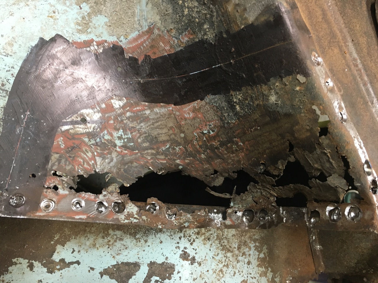

Steve, no such thing as too far gone, take my word for it, great area to hone your metal working skills. It is slow going but very doable. Just one example of the many repairs done and still to do. Good luck, Frank

As a total beginner in sheet metalwork/body work that was the area I started on. You can always cut out your repair if it does not work.
The second photo is what the PO had done to repair the area. The last photo is my finished repair before I did a bit of cleanup work.

Charley the pictures I showed were the back side; the front is much worse where the edge is. I did not see how badly it was until I got the rear fender off. I did not have the courage to show the rust all the way through.
