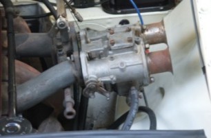

And for some eye-candy, the ONLY real downdraught Webers:

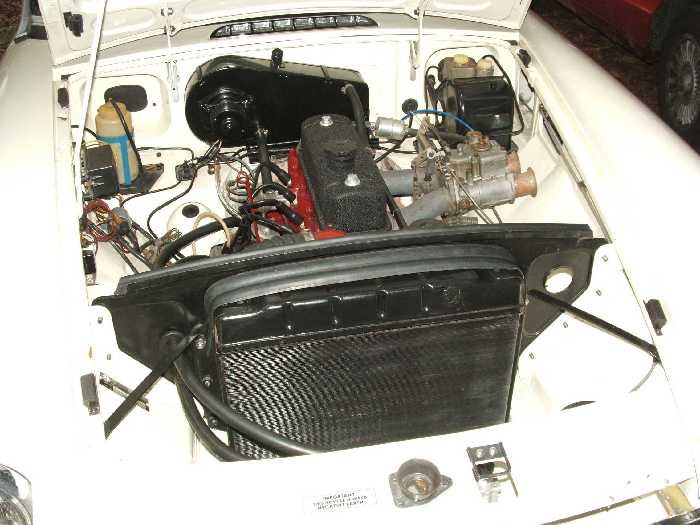

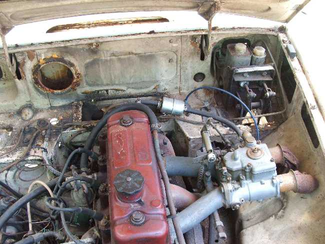

A "before" of Her engine bay:
And the "after":
This intake was ho-made, fabb'd up back inna mid '70's using BMC's "Special Tuning Manual" as the source for the thing. Works a treat, too. :wink:
Doc's setup sounds as good as it looks, too.
