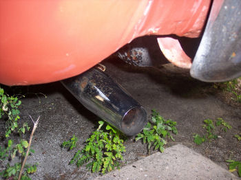

And I use a Harley Davidson flow-thru chrome unit /bcforum/images/%%GRAEMLIN_URL%%/grin.gif (Needs a little clean-up too /bcforum/images/%%GRAEMLIN_URL%%/blush.gif !)...(can be had free/cheap from Harley guys up-grading to fancy pipes!!)
PS: Sounds Great on a Spridget!!

Looks a lot like a rocket assist exhaust, hehe.
Jato bottle Doc.

What is the inlet OD on these?
How loud would my 1500 be feeding into one?
Hold on I will run out and measure... be right back!
1.75" ID...(same as the dia. of the header I am using!!) /bcforum/images/%%GRAEMLIN_URL%%/grin.gif
