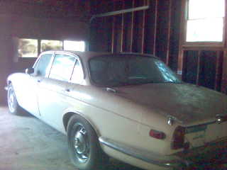

here's the Old English White Series 2 XJ, looks good and straight to me, I don't know if it's a 6 or 12, or the year, it looks like a 1977, or if it's really the awful yellow color. the picture is terrible, the car is sitting in the garage since the owner's recent passing. you'll have to buy from the widow. I understand there is a parts car too, or a cache of parts. I sent you their e-mail by PM.
Good luck!

Exotexs,
It is Olde English White. One in the yellow just sold on Ebay and no lighting or bad photography could disguise that color! It looks like a stretch limo version of my car.... Looks very original and solid as well. Good find!

Hi Russ,
No, I haven't seen the car in PA, I just meant that in low-light settings my Olde English White paint has that yellow-ish hue. It catches me off guard at times, in the sunlight my car is fairly bright white. It must be the tint in the paint mixture. I think Pale Primrose is what Exotexs was referring to, the yellow he mentioned. Unless that is just a very pale picture, I would say it is Olde English White for sure.
