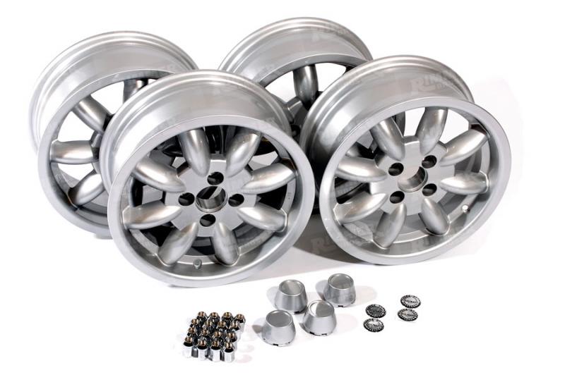

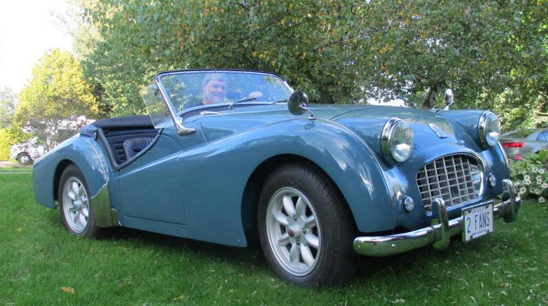

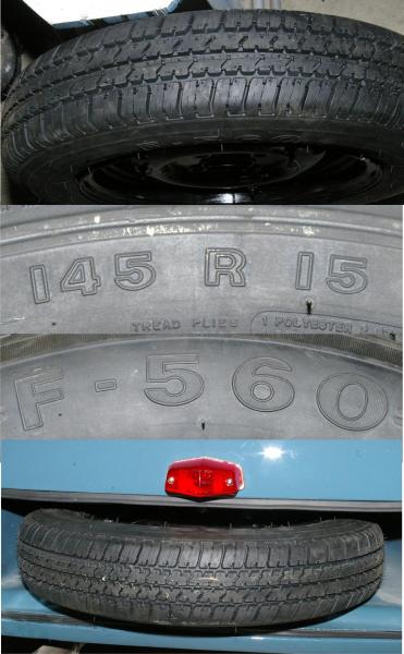

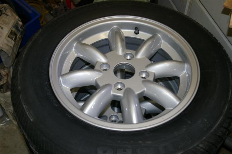

Jim, I faced this issue when restoring my 56. I did not have four straight steel wheels. I ended up getting 5.5 x 15 rims that were 8 spoke alloys from Rimmers in UK (I could not find any 5 inch ones, which would have been my preference) and installing 165/80 x 15 tires. For me, it was less expensive to order from the UK and have shipped to Canada than to order from US. For the spare, I used the best steel rim that I had and bought a small tire to fit in the very narrow compartment in my early TR3. Here are some pictures. So far so good. Cheers, Mike

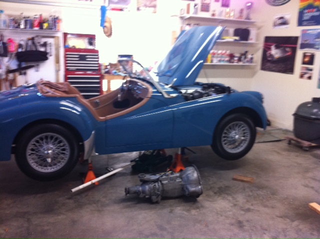

Mike - That is a good idea on the UK wheels, I think Rimmer sells Minator wheels. With the US dollar strong right now, that might be the way to go. Thanks for the pictures, I like the color of your car - see blow, very close to mine.
