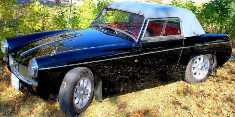

I am running 175/70 r13 on 5" rims. General Altimax RT's.

Lee, the black chrome looks great.

I have not noticed any problems so far. They fill the wheel well compared to the 165/65 13 Bridgestones they replaced. Mistral rims.
Pic is of the 'removing the rear flares' stage.

Thanks Jack. Grill was powder coated years ago and I hit the budget limit so I figured why not paint it and see how I like it. All the chrome was pitted and peeling and the paint comes off so easy.

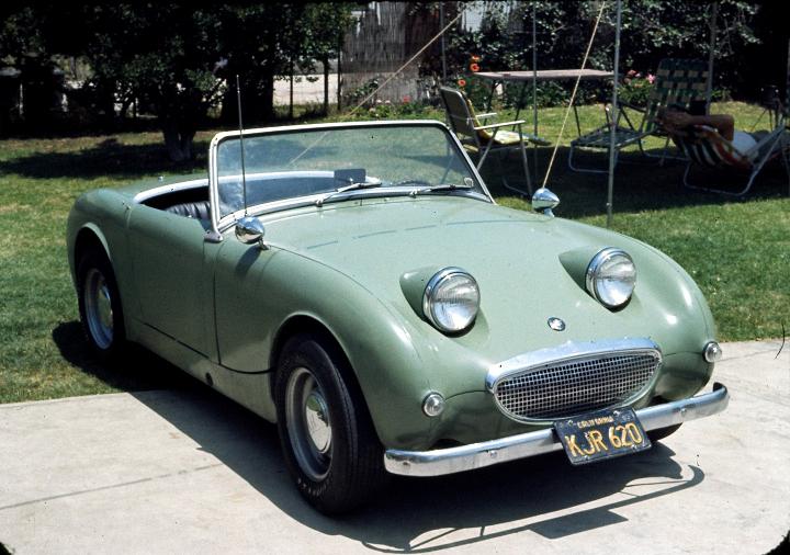

Thanks. The flares were added in 1974 when it was last painted. It had Custom made rims on it then. This pic is from '74 just before leaving on the trip to Limestone, Maine.
