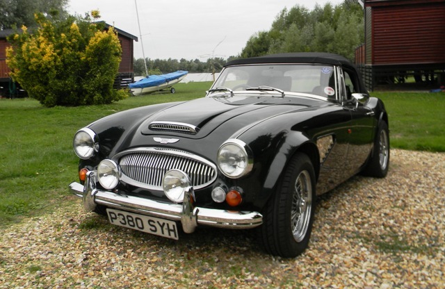

Could is be you have one of the HMC MkIV's
https://www.historics.co.uk/buying/auctions/2013-08-31/car/1997-austin-healey-mk-iv-by-hmc.aspx
