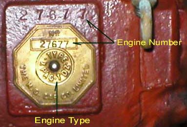

Gunner - As stated by the other posts, the Gold Seal engine was one that was supplied by the factory way back when. It is not a special engine, just a standard XPAG T series engine that was rebuilt by the factory. It wouldn't take many rebuilds, withthe block and head being hot tanked for all of the gold paint to have dissapeared, so searching for remnents of gold paint would not be a reliable way to determine if the engine is in fact a gold seal engine. Steve is correct in saying that the Godl Seal engines have a different serial number from the original engines, but I don't know how the numbering system worked for those engines. Someone in the New England MG T Register <https://www.nemgt.org/> may be able to shed some light on the system. In the meantime, the standard engine numbers are XPAG/TD/99999 or XPAG/TD2/99999, and it can be found on an octagonal plate either on the arch where the bell housing attached to the engine or one attached to the right side crankcase, just below the front carburetor. You will also find the engine number for the original engine that came in the car on the maker's plate on the front of the tool box, drivers side of the car. See the attached file for the interpretation of the plates.

Sid - Did you take the engine number off of the plate on the engine or from the maker's plate on the front of the tool box? The number that you qouted, 21200, is too high to be from a 51 TD, so I am assuming that it came off of the plate on the engine. If you look closely at the center of the plate, I believe that you will find that the XPAGTD portion actually reads XPAGTD2 (see attached photo) . This would be a late engine (somewhere around late 52 to 53) and will have the longer rocker shaft and the larger, 8" clutch. It will also have the later metalurgy used for the crank, which makes it much less apt to crack. Also, Tony is correct, the engine is not a Gold Seal engine, but being a later engine in the series, it is a better engine than the original, in my opinion.

You are correct, Dave.. My number plate says XPAGTD2 in the center, which is to my advantage, except the numbers don't match the ID plate. The block and number plate say 21200, so this is not a gold seal engine and I'm guessing that's not necessarily better, either. The pan will come off next week and I'll know more about my little purchase.
