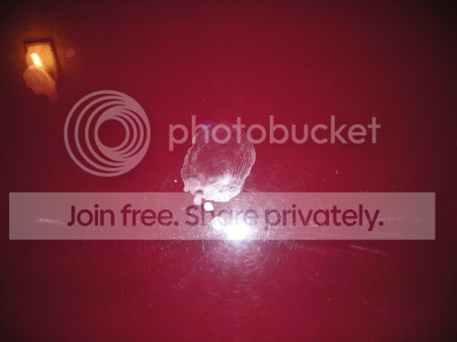

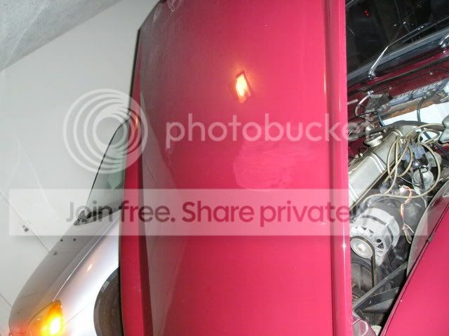

In my ongoing quest to be my own worst enemy, tonight I took some denatured alcohol to some pine sap on the paint of my car. Removed the pine sap beautifully!...and the clear coat as well, it would appear. I'm not sure clear coat is what I have on the car, but whatever it is, the alcohol buggered it up pretty bad. /bcforum/images/%%GRAEMLIN_URL%%/cry.gif Any suggestions for damage control? I'll just be downstairs taking a ballpeen hammer to my head... /bcforum/images/%%GRAEMLIN_URL%%/wall.gif
I would first try a high speed buffer. If not available, use rubbing compound.
If these don't work, try 2000 grit paper. Wet sand with that, if it is not too deep it should come out. If necessary, try 1500 or 1000.
No problem. I wouldn't worry about it. I did the same thing to a part of my trunk lid. The ballpeen actually feels quite good and evens the score without a lot of angst.
...and NEXT time, use mineral spirits...
The compound trick might work, but more than likely you removed the clear coat.
Thats what happen to mine when I saw a couple scratches, I thought it could just be buffed out with compound.
I ended up having to have the entire bonnet sanded even, buffed & re-clear coated.
It looks much better now! (400$ later)
I would not think that cured clear coat could be removed by using denatured alcohol. IMO it looks like you just scuffed the area. I would take it to an auto detailer. There should be lots of them in Santa Clara Valley who can do it if it can be done. Else, off to your favorite auto paint shop.
