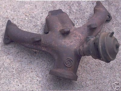

I started the car, backed out of the space and as I gave it gas to leave and heard a loud pop (similar to backfiring). Instantly it sounded as though I was driving a small tank. I stopped to check the engine and couldn't see anything unusual.
Luckily I was in the neighborhood of a friend and fellow Midget owner, Trevor Jessie (great guy). Upon closer inspection, it was determined there was a crack in the exhaust manifold, but it was too hot to examine in any detail. The next day I realized something must have fallen out or off, because it wasn't a crack, but a threaded hole.

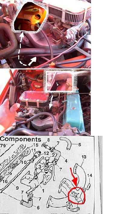

Unfortunately a search of the parking lot proved pointless. When I plug the hole, it sounds fine. I'd like to find out if anyone knows what and whereI can find what might have been there or good ideas as to what I can do now. It's embarassingly loud. I've tried parts catalogs, but it's impossible to tell what it was. It's got the weber conversion on it so I know there were mods made to that unneccessary emissions stuff. I've attached pics. Hope you can make heads or tails of them.
