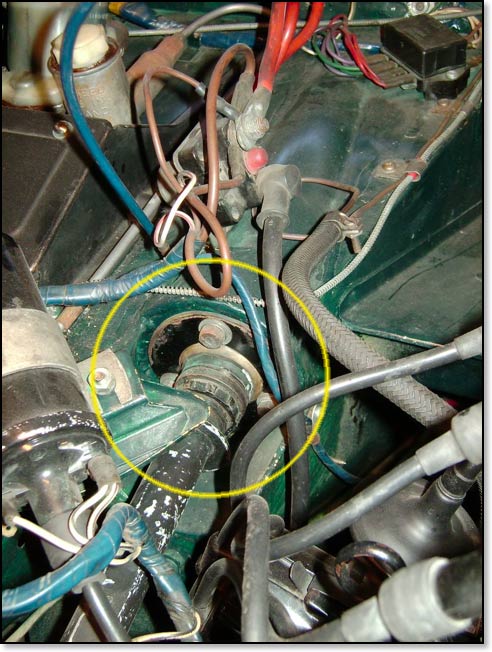

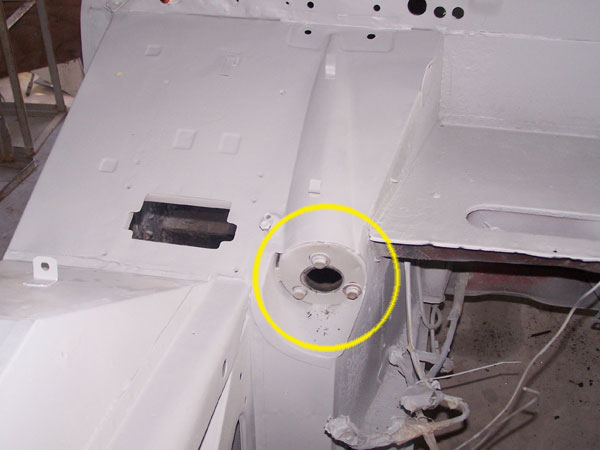

This is where the washer goes.
Wazza

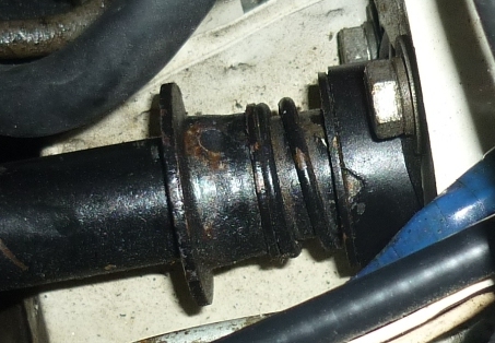

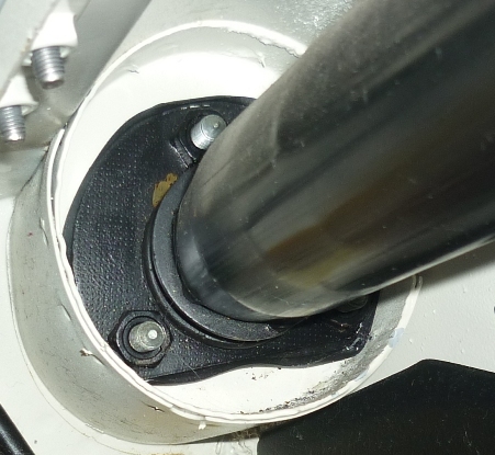

Warren, it both hold the steering column in place and is part of the collapsible wheel. recently we had a discussion about one which had slipped. In the meantime here is some pics from mine - hope this helps.

Thanks for your comments JP, and those great pictures, and link. Your bottom photo shows the thinner gasket/washer which I have in my cockpit.
The top photo is subtly different to how the column looks in my '79 model. It looks like you have some sort of extension collar where your three bolts are, while mine had the thicker washer instead.
The collapsible comments make a lot of sense, because the thick "ring" a bit down towards the steering rack would move up in a collision and be stopped by the thicker washer, thus allowing the collapsible piece inside the cockpit to collapse. Looks like I can have one made up and not lose any safety.

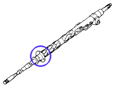

I found the photo below while trawling around the internet.
Thanks again.

OK . . . I give up . . .
I've been pulling the internet apart, I've contacted all the "big" Midget supply outlets, I've contacted all the Midget wreckers I can find, but I just can't find anyone with one of the thick washers I first asked about in this thread.
JP came up some photos etc, but unfortunately it appears that the 79 model had a different setup at the inside of the firewall. The thread that JP mentioned is for an earlier model to mine and the steering columns are entirely different.
Does anyone have one of these thick washers sitting on the inside firewall of a "donor" late model Midget? You can see the thick washer held on by three bolts quite clearly in the last photo.
The only thing I can think of is to get one made out of steel, but i'm not too sure if there is a "collar" which goes into the firewall to join up with the collar of the inside washer as shown in JP's second picture.

IIRC that is just a flat metal flange the holds against a shoulder on the column. I think it can be hand made with no problems.
Thanks for your replies. If there is no collar then I can get one made OK.
