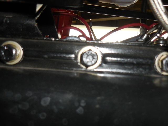

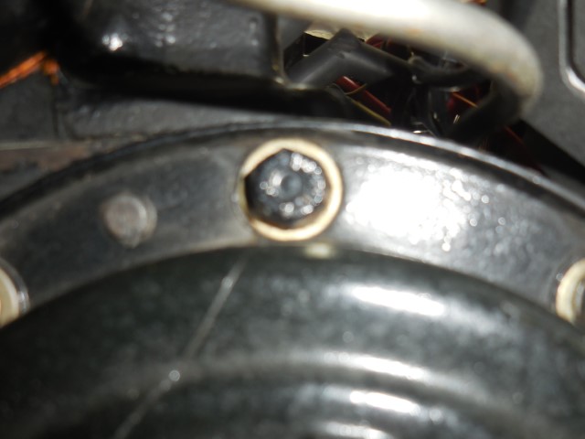

To help with getting more flat surface over the bolt hole and not deforming it, I use 1/4" washers on the oil pan and the timing cover.
What kind of sealant I used, well that's a good ?

TR6easy - I was wondering why that wasn't done from the factory. That would seem to help with the "belling". I might do that to although from what I've read it isn't a issue unless it is overtightned
