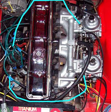

Maybe I don'y know where to look for the throttle
bypass valves. Here's a top view of my engine.
Do you see the throttle bypass valves? If so,
point them out to me.
PS; My intake manifold sucks at 17 on my gauge.
The light blue are my twin vacuum pipes.
Thanks

They are hard to see from that angle, Dale. For the CDSE versions they are on the right side of the carb between the temperature compensator assembly and the throttle shaft. There are usually 3 Phillips head screws and 3 slot headed screws holding the thing together.
There are good pictures in the Buckeye Triumph article on carbs.
